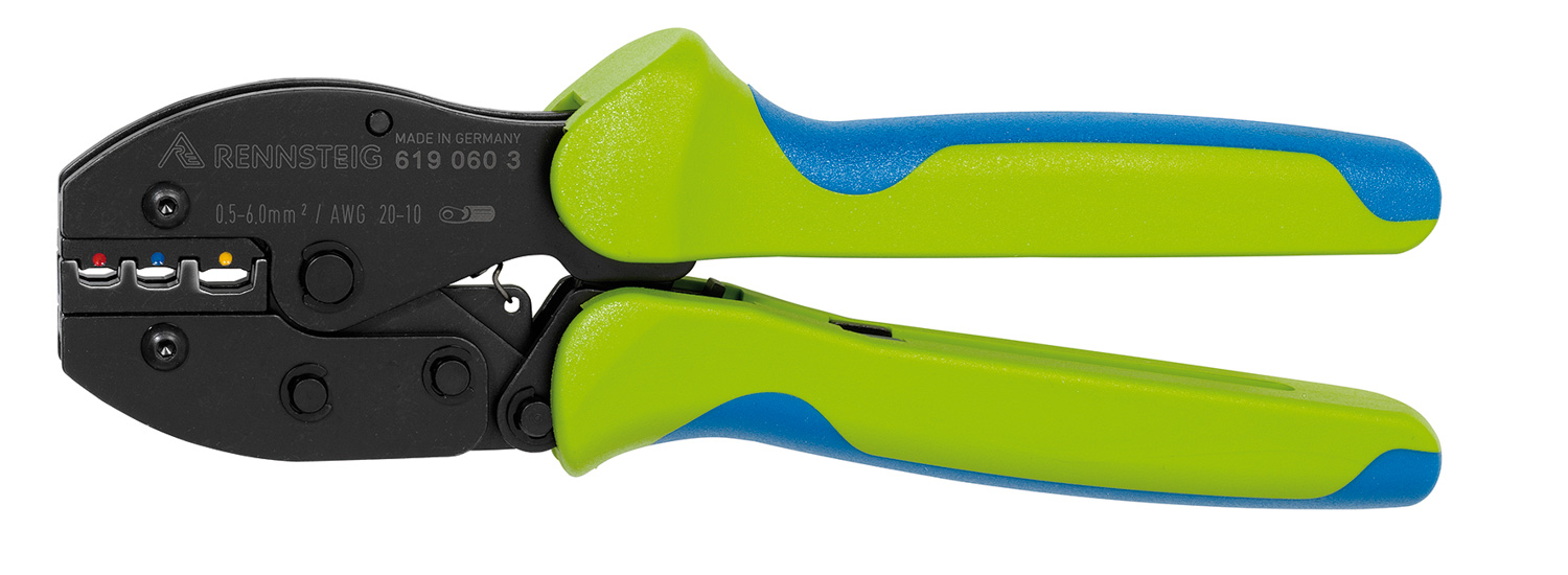

For AMP Terminals I like the aircraft quality PEW crimpers made in Germany by Rennsteig. The AEA had Rennsteig tools in their classroom and I was impressed enough to order up a Rennsteig 619 060 3 0.25-6.0MM crimper for my every day use. Cost me $211 in 2016. It does the double crimp (wire contact and insulation strain relief). High quality product:
Rennsteig also makes some great wire strippers that release at the end of their stroke.

Are they really any better than the same looking ~$35 version from Amazon? Replaceable jaws, adjustable “squeeze”. Stein air sells them too..
