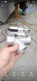

Jeremy,
Pic below of the wye I used from ACS. The solenoid was ordered off Amazon and I built the adapter.
This wasn't done because of hot tunnel, I had no issues before, but it had a little warmth. Absolutely zero tunnel heat now.
I did it because the hot air would dump into each other mid firewall, and because I have a plenum and no leaks, there didn't seem to be any air flow to pull all that hot air out of the upper firewall area, which was burning out my main alternator fuse which is mounted copilot side of the firewall at around the same level as the heater valves. I ended up installing a temperature probe in the area and was seeing temps in that area above 200 degrees. After installing the wyes and diverting them down towards the cowl exit, the area in question temperature lowered significantly, roughly coincident with block temp (oil temp minus a little).
The scat tube coming off the wyes is rtvd into the triangle of the front gear pointing exactly at cowl exit. So when the cowl flaps are closed, there isn't a ton of cooling exit area. Even summer through Texas cruise temps were around 350, so still plenty of cooling flow.
I should mention, when the wye is open to provide heat, the flow is slightly reduced from prior to this mod. Still plenty of heat IMO, and I hardly use the heat, but if your mission is way up north in the winter, this might not be the mod for you. The wye either dumps everything, or splits the flow, it doesn't do one or the other.
