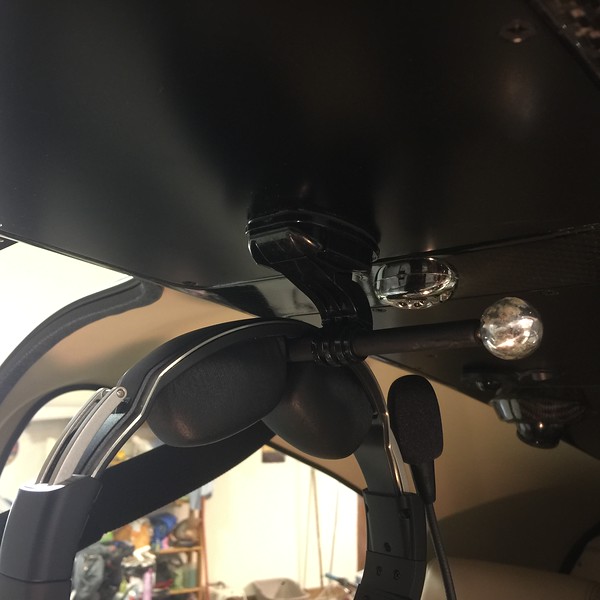

Headset Hanger
I made this one from a length of 6061 tubing tapped at either end for an AN-3 thread and added a couple of 3/4" aluminum balls from Mcamaster.
Covered with a piece of heat shrink and pressed into a goPro mount drilled out to size. It can be swapped out for a camera mount or other things like oxygen regulators.
