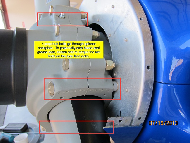

Found this after the last flight. This prop has 100hrs since new, has been dynamically balanced and was in the box just short of 2 years before the first flight last March.
Short of removing it and taking it to a prop shop...what can I do?

Check the torque on the two bolts right at the hub - in your picture, they are the ones with their heads facing towards the viewer. One is at the leading edge of the prop, one is at the trailing edge. My prop manual is at the airport, but I believe the torque values are in there.
Grease probably just separated while sitting, Wipe it off and keep flying it, add some fresh grease around 20-30 hrs.

To expand on a previous post:
May not be the OP's issue, but DanH offered this advice many years ago and saved me an unneeded reseal on my previous RV-8's Hartzell prop. Worked like a charm. Here is a pic of my previous RV-8 with some notes:
Attached below is an earlier version of the Hartzell Propeller Owner's Manual No. 115N (61-00-15), Rev 23, Feb 2018 (prior to the introduction of Nyco GN3058 grease).
- Table 3-1 on page 3-7 lists the torques values. "Hub clamping bolts/spinner mtg. nuts 20-22 ft-lbs (28-29 N•m)”.
- See Figure 3 on page 3-10, which shows the hub clamping bolts, like the picture I included above. Obviously, the other 6 bolts that actually hold the hub together should not be disturbed.
- Page 3-11 through 3-13 talks about metal spinner bulkhead installation using those bolts.
- Figure 3-4 on page 3-12 shows the spinner mounting bolts and the spinner bulkhead spacer and stack up, just like on my airplane.
Check to make sure all that makes sense for your prop and hub, as it’s been awhile since I did it.

Clean what you see off of the blades and hub. Label clean blade #1 near the hub with a marker and suspect blade #2. Check the 4 aft spinner bulkhead mounting bolts torque. There should be a placard on the propeller front dome stating what grease it is serviced with. You will have to remove the forward spinner bulkhead to see this.

Update:
I finally got some good weather and flew for 2.5hrs. Slinging grease worse than ever. Removed the prop and it’s currently at the prop shop having new seals installed.
Let this be a warning, don’t let the prop set uninstalled for two years… the seals can take a set.

Just for the record. I picked up my prop from the prop shop yesterday. The problem was, there was grey clay like substance packed into the prop. Apparently this caused the leak. I thought the oil coming out of the prop and crank when I removed the prop looked awful. I'm going to have to figure this out before reinstalling the prop.
