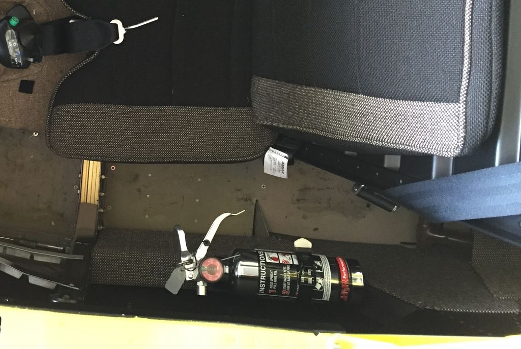

Not by our airplane right now....want to buy a Halon fire extinguisher to put between the pilot and co-pilot seats on the forward slanting column under the throttle/choke controls. Anyone have the dimensions of that section?
These are my choices for Halon 1211 extinguishers
http://www.amerexfireextinguishers.com/Amerex_Product_Catalog.pdf
scroll down to Halon 1211 either the A344T which is 10" high or the C352TS which is 14 3/8 high
TIA
Not by my plane either, but I believe I ordered this one from AircraftSpruce for just over $100. Small, under 2 lbs.
H3R FIRE EXTINGUISHER MODEL A344T
Installed nut plates on the F-1230 tunnel cover. (Cut holes in the carpet for the screws to mount the bracket). Very accessible for pilot and passenger.

My RV-4 Extinguisher
Here's the one I put in my RV-4 - http://amzn.com/B001KAO63G. The chrome version cost an extra $10 but I think it's a nice touch. The cockpit photo is looking straight down over the front seat. I know it looks like the handle might be in the way but it's not. It's well clear of the passenger's left foot and below my left forearm. Easy access for me and doable from the backseat too.
Use Halon in a ventilated area. Your cockpit is a small confined space and will fill rapidly. Nothing really wrong with its use just open your fresh air vents.
