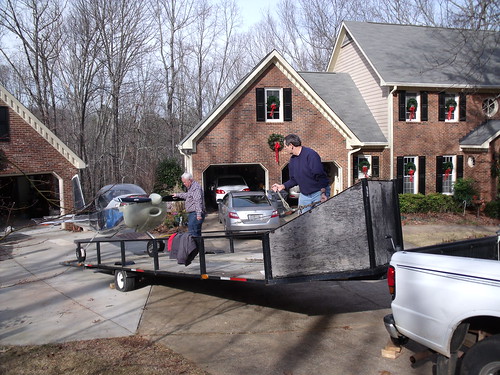

On Wednesday we dragged #16 up to Cartersville Airport for it's inspection by Mike Huffman. We just need to re-mate the wings, drain the gas tank, calibrate the Dynon, and some other dumb stuff... I don't think we'll be in the air before the first of the year. We'll keep ya'll posted.

We joined a group called Georgia Light Sport and they had a trailer that was about 20 feet long that we were able to borrow for the transport. The weather is intermittently nice, about 50 degrees and ok for local work in the air. As I said, I doubt that we'll be in the air before January.
George and Meade. That trailer looks just what I need. I plan to enclose it to keep the muck off the plane. Great Pic.... Thanks.:):)
trailer
Our trailer was strictly for transporting; you may want to think about taking the wings off and on every time you want to fly, unless you're not going to be up and flying very much. It 'ain't' as easy as the videos show installing and removing the wings. That space that they allocate for the wing spar needs to be increased by about 5 feet :) to safely install the wings. I've already managed to tear a nice little rip (you won't see it with the wings on) in that gap. Best of luck
