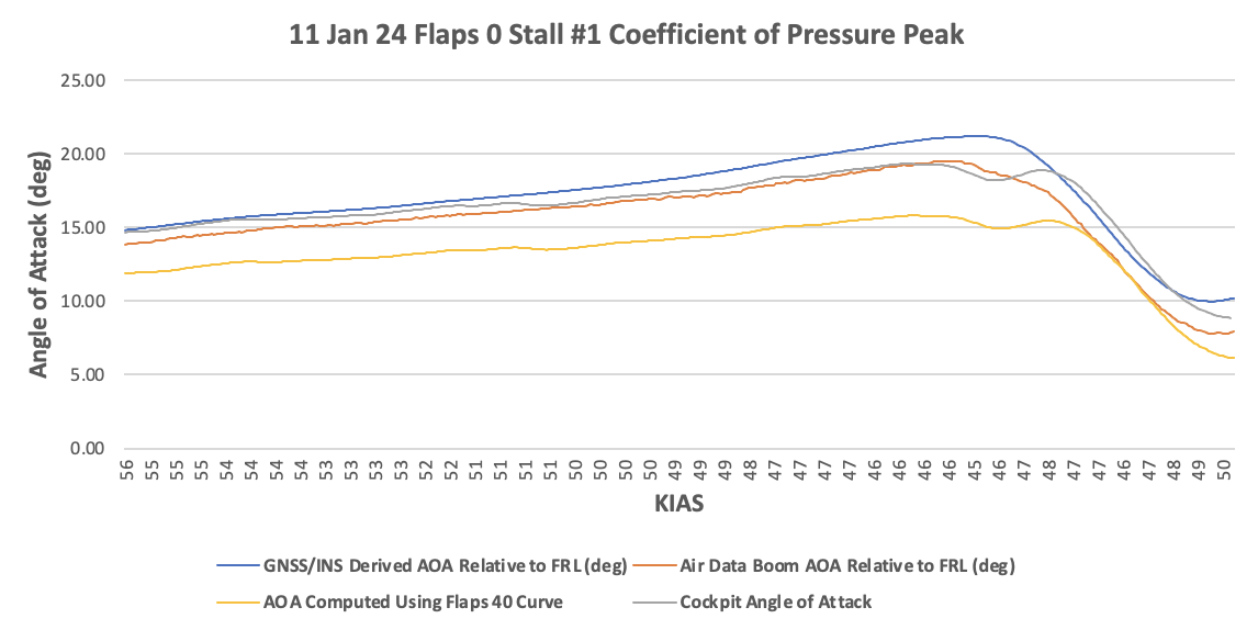

If a coefficient of pressure-derived AOA system is used to provide stall warning, the stall always occurs at peak coefficient of pressure. There are various means to determine coefficient of pressure, but the simplest is to divide one pressure by the other. In our system, we just divide the offset pressure by dynamic pressure. The "offset pressure" is the extra hole in the sensor, offset "x" degrees from the dynamic (pitot) pressure.

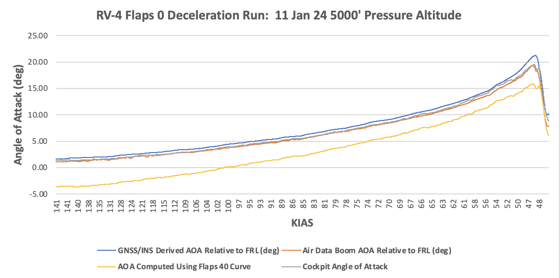

To prove Bob's point, let's look at a deceleration run from high speed cruise into a 1G, Flaps 0 stall:
Let's blow up the right side of the plot so the peak/stall is easier to see:
The two lines to focus on are the coefficient of pressure outputs of the airplane system. These are the grey line marked "cockpit angle of attack" (flaps up) and the yellow line marked "aoa computed using flaps 40 curve" (flaps down). It's the same coefficient of pressure inserted into to different calibration curves. Obviously, the correct curve (grey line) accurately measures AOA and the yellow line (wrong calibration curve) does not; but what's important is where peak coefficient of pressure occurs--both calibrations accurately capture stall. Obviously, the Flaps 40 calibration doesn't correctly compute angle of attack in degrees, but it doesn't matter in this case, the system still accurately measures when stall occurs and provides progressive warning.
If a coefficient of pressure system is used to measure actual body angle (difference between the relative wind and the longitudinal axis of the airplane in actual degrees), then an accurate calibration is required for each flap setting. We first noted this during ground effect testing. Operating in ground effect changes the critical angle of attack, but the effect is essentially nullified since peak coefficient of pressure still occurs at stall. Our system accurately measures AOA using coefficient of pressure, and I can observe the airplane flying out of ground effect on takeoff (momentary increase in AOA after rotation/lift off) and flying into ground effect on landing.

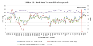

Let's start with the base/final case. In this video, I'm just flying a normal (wide!) overhead to a touch and go. I'm not being particularly pure about maintaining an on speed condition, and fly most of the turn in what we call a "slightly fast" condition relative to on speed. On speed is used for approach/landing and equal to 1.73 L/Dmax AOA, which correlates with 1.25-1.35 Vs. It occurs with the ratio of actual coefficient of lift to maximum coefficient of lift is 60%, or what is sometimes referred to as a 60% lift condition. It's not a single AOA, but rather a small band (about +/- 1 degree) in a light plane that provides a cue equal to +/- 2 to 2 1/2 knots of desired AOA at 1 G. In other words a band about 5 knots wide. All AOA systems use a similar technique, but the range of body angle will change depending on the airplane. For example, an F-18 band angle band is narrower, but provides a similar IAS range. This is sufficient to catch a 3 wire aboard a pitching deck at night. It's also sufficient for driving auto-throttle input in the big jet I fly at work. More than sufficient for getting my RV-4 to the TDZ with just the right energy for landing.
Now let's look at how the three sources of AOA information compare in the video. Here's a plot that shows AOA and IAS:
Notice that the pressure Derived AOA and the AOA of the air data boom marry up nicely throughout, but the IMU algorithm is challenged even at the relatively shallow bank angles flown. The good news is that the phase aligns nicely and the IMU-derived AOA is "timely."

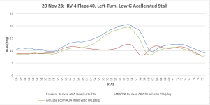

Now let's look at where folks get into trouble with the aerodynamic limit of the airplane. Most GA loss of control mishaps occur at "low" G, i.e., less than 2. Here's a video of a flaps 40 accelerated stall flown during a simulated base turn:
And here is a plot of the measured AOA during the maneuver:
In this case, the IMU-derived AOA detects stall, but notice the difference in relative accuracy compared to the other AOA solutions. We know this because the peaks are aligned.

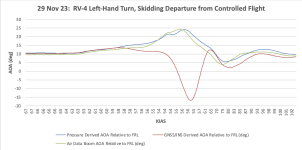

Now let's look at a more extreme case, a skidding departure from controlled flight. This occurs if the pilot tries to "rudder" the airplane around the turn, but applies opposite aileron to keep the bank angle from getting too steep. A classic "uncoordinated" situation.
If we plot the data from this maneuver and once again compare our AOA solutions, we see some interesting behavior from the gyro-derived AOA:
In this case, I'm not sure what the IMU-derived AOA indication would provide, so that would be an interesting test point for some one with an IMU-derived AOA display/tone. We don't drive any of our displays with IMU-derived AOA, so have no way to assess performance real-time or using video de-brief. Our system uses the indigenous gyro for calibration only, and we derive AOA from the GNSS/INS reference system post-flight only. BTW, if you are an AHRS guru that can code matrix calculus and handle Kalman filtering, we'd love to buy you a beer and pick your brain :cool:.
