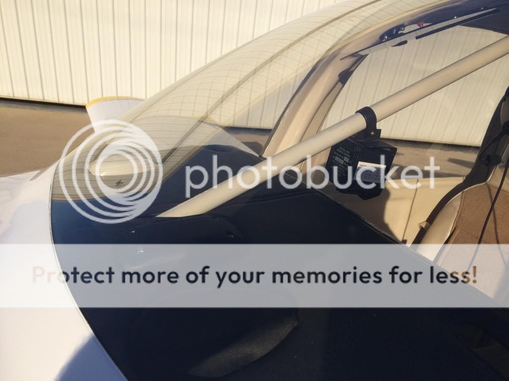

I would like to move my GPS antenna's from the glare shield, they create a reflection on the wind screen.
Taking in account the plane is complete I am looking for options to other locations. I noticed in a picture today two GPS antenna's mounted in front of the wind screen behind the fire wall, out side of the plane. Is this a good choice, and any other ideas?

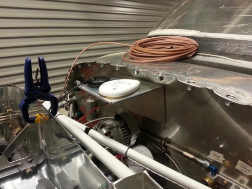

I mounted both my Garmin and Dynon GPS antennas in the engine compartment, this ensures no reflections, both antennas have no issues seeing the sky through the fiberglass cowl and the heat of the engine compartment has not bothered them in nearly 200 hrs.

Same story except no problem in 1,000 hrs.
Top motor mount tube just forward of fw--400 hrs with no problems! Several friends have theirs in the same place. Heat is not an issue.

Like others have done, one of my GPS antennas is in the engine compartment along with the xm antenna, works very well.

Just mounted mine, so untested, however, did as many are doing. Created it for firewall forward and high under the cowl.
Easily mounted using rivnuts and a little geometry in making up the mount.

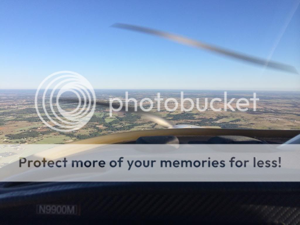

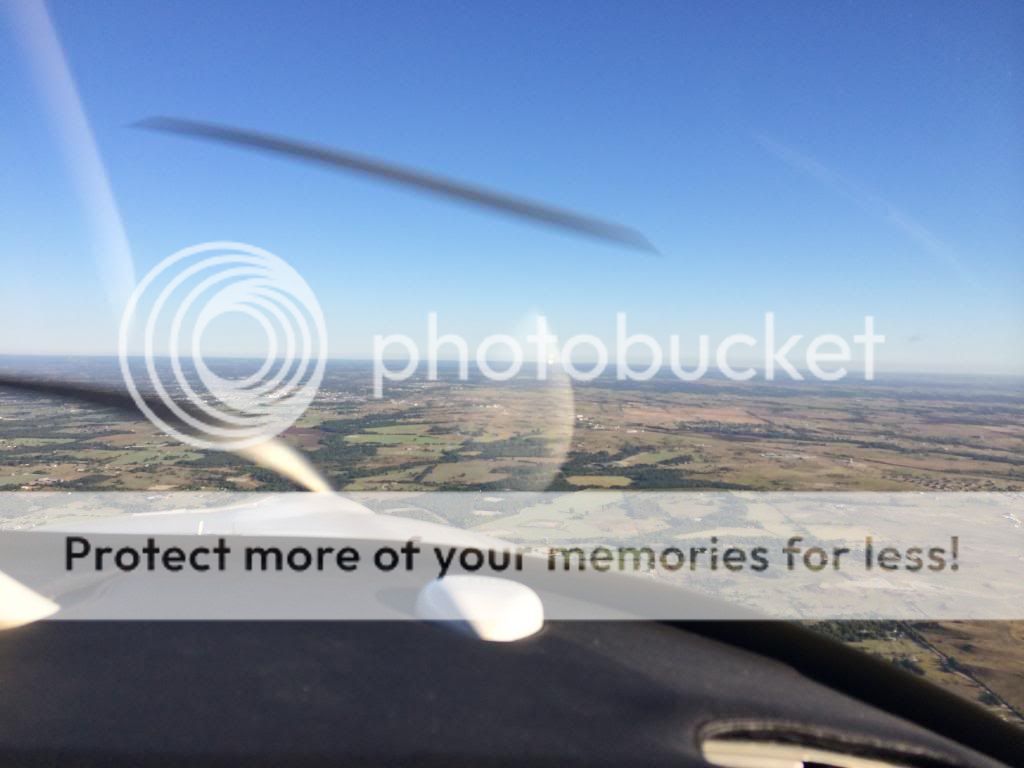

After covering two I took a test flight before covering the third, check out the difference in the reflection.
Uncovered.
Covered.
The antenna's blend in well with the glare shield pad, stay cool, and no apparent reception issues.

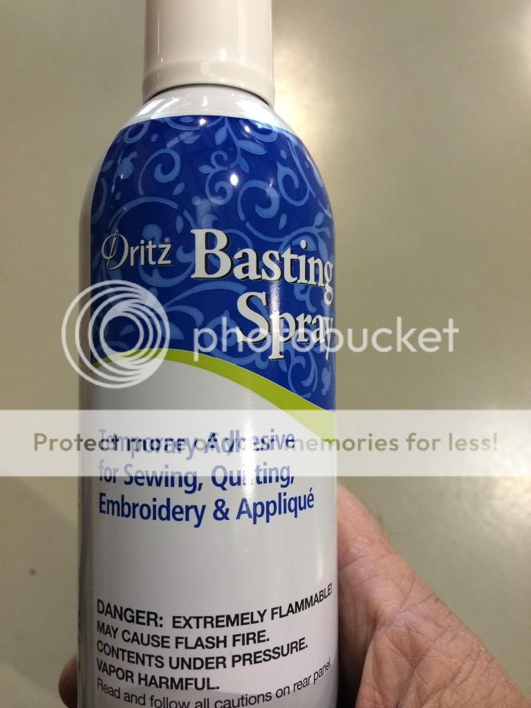

Here is the temporary adhesive I used.
The adhesive is very flammable and needs time to evaporate.
