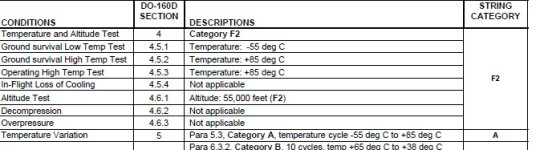

See Garmin data for a WAAS antenna
Was able to find what I think applies to our antenna's. 85 C is 185 F.
