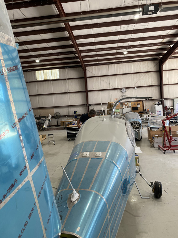

I have my GPS antenna's both mounted under the overhead console . Below is a picture of one of them. They are both working perfectly. However, even with the 90 degree TNC adapter the cover does not fit without a hole for the connector. I am going to mount my rear headset hangar in that location so the hole will be covered eventually.
I mounted the antenna to the rear cover on my aerosport there is more room behind the roll over bar in the top. It works great. My GTN650 shows the strength of the signals and the are strong.
Do you have a pic or two that you could post? My antenna's don't fit - similar to the picture in the above post.
