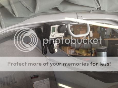

Hi Gary ,
I will post a picture of a simple clamp mechanism for attachment to the rollbar when I get to the hangar tomorrow.
The cockpit video of my first flight was taken using the GoPro attached to the rollbar.
http://www.youtube.com/watch?v=SiEasiXeKyo
I have not tried any other mounting locations yet but I think the rear bulkhead location won't provide much of a view.
The in-camera battery will not provide but one hour of recording time at 1080p so I am now using the BacPac accessory battery sold by GoPro to extend the time.

Mount
Hello, We used a inspection plate on the bottom of the plane. Take one of the mounts and four nut plates, match drill the mount and install nut plates and your ready to video. Some videos can be found at November 328 kilo lima on you tube or Facebook. Works great.
The GoPro suction mount is plenty stout and can be affixed to the canopy about where the passenger's head would be. Just configure the camera for inverted recording. This mount position permits shooting in just about any azimuth.
The rollbar mount works well on the handhold on the wingtips. Couple of tiewraps for security's sake. Double-check the remote function before you blast off.

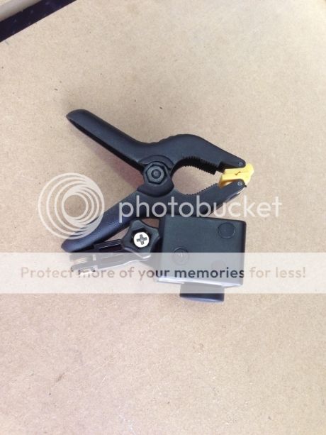

For my camera mounting, I would have liked to use a RAM mount that consists of a U-channel with a couple of tightening screws and a 1" RAM ball. However that stock mount can handle only about a 1" thick clamping width, and the roll bar is closer to 1-1/4". I therefore had to fabricate my own out of some 1/4" thick aluminum channel (cut from a 3"x3" square tube. This clamp can then be placed anywhere on the roll bar (as long as it doesn't conflict with the canopy latch handle, and the RAM ball connected to a similar 1" ball screwed into the camera via its 1/4-20 screw hole. I'd post some pictures, but I'm steadfastly avoiding the 105+ degree hangar temperature here.
I agree the GoPro suction cup works very well. Once I installed the Koger sunshade my favorite location for the suction cup was no longer available.
I found a youtube video modifying a Home Depot clamp and I am happy with the simplicity and location even when the sunshade is fully open.
