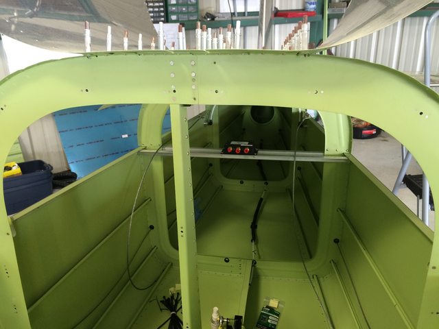

I usually make a shelf between the longerons 1 or 2 bulkheads back from the rear baggage wall.

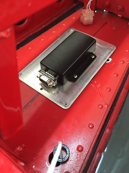

Just for reference, here's my install under the vertical stabilizer in my RV-8.
Drawing the centerline is obviously much easier if the stab is removed.
The little shelf you can buy from Spruce and Stein would probably have helped me here if I had know about it. I had run an electric trim wire through the 4" hole in the stabilizer for the initial build and now I had to move that wire so the plate would lay flat for the GMU11. That move required me to rewire the AMP plug (seen in the background) to my electric trim which was a real pain (I hate removing those pins). That process took longer than the GMU 11 installation.

Here's a picture of mine on the RV7. I kept the wire bundle for all the other tail stuff separated from it by a few inches, but I don't know if it actually made a difference. When I ran the interference test with all that stuff turned on it passed with I want to say 17% or 18% of max allowable interference.
If you really want to be sure, the way to do it is to run everything but leave yourself nice long service loops and don't nail it down permanently until you get everything hooked up, even temporarily, and do the interference test.

Have a look at the F-00149 ADAHRS Tray I designed for the RV-7 & RV-9. It already has mounting holes for the GMU 11 and the Dynon ADAHRS.
Match drill the 10 mounting holes and pop-rivet it in place. It works great for the GMU 11 in my RV-7.
The details are in the OP-60 document and it's available here.
