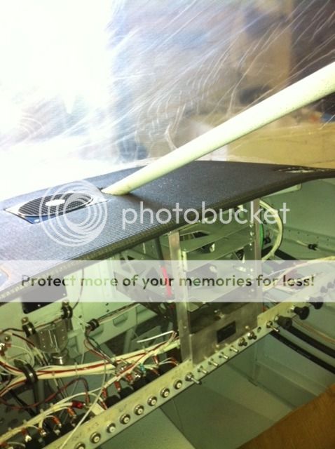

I put slit autozone fuel line over the sharp edge. I then put 1/4 closed cell foam over the top and then covered it with a textured walmart yoga mat rolled and glued over the foam and fuel line.
Looks great, easy to clean, easy to replace if the need arises (although I did the initial install before the windshield was in place.)
About $35 in materials and a half days work. Gotten a ton of compliments on it.
