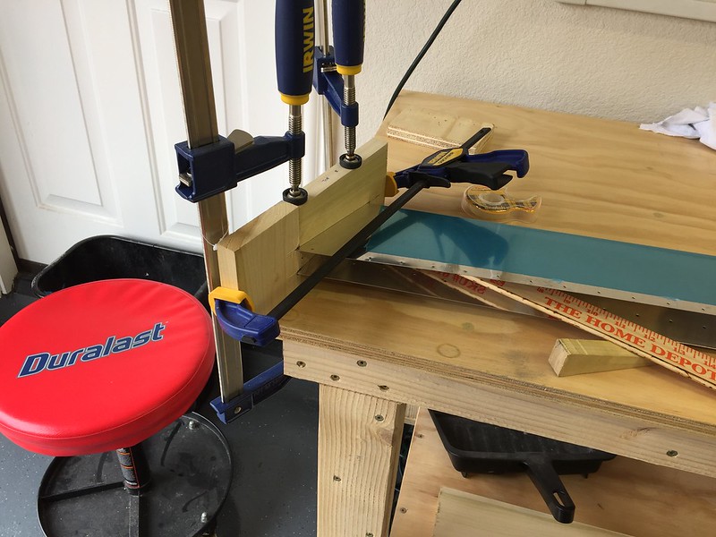

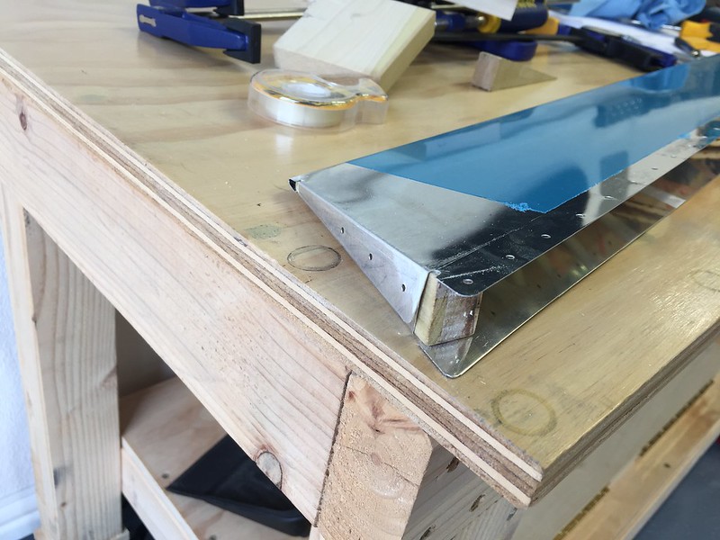

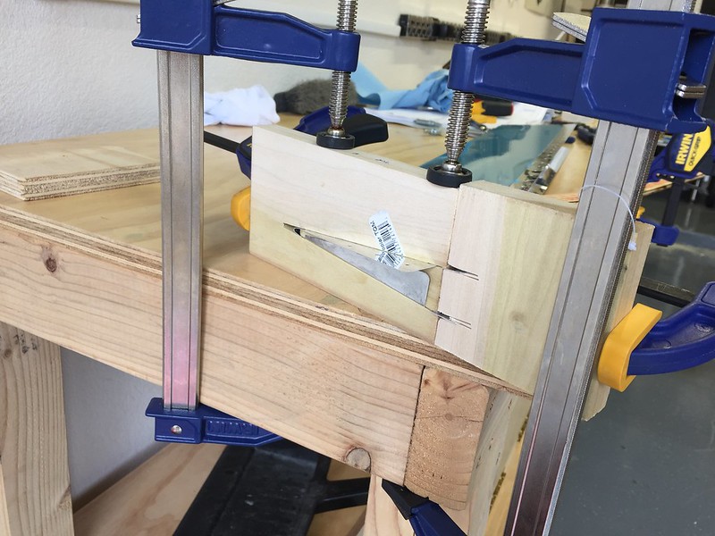

Ever since purchasing the empanage kit and reading about the infamous trim tabs, I have been dreading the tip bends. Well, this weekend I tackled them and can't believe they came out. A lot of thanks to all the builders and forum posts about this in the past, your insight and experience paved the way for a successful weekend. One big pieec of advice I can impart is to make sure the wedge block does not move. Creating the wood wedges and then using the yardstick was a huge help.
