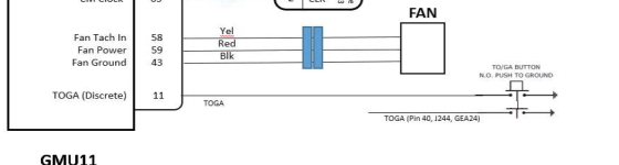

Weird coincidence ! I was just trying to figure this out yesterday for my G3X Touch/GMC307/GEA24/GTN625 system going into my scratch build 4pl Bearhawk :)
Rev AP the G3X Install manual has the first attached image below on page 27-9.
The second attached image below is a clip from my electrical drawings. I chose pin 11 on the GTN (and I will configure it in the GTN when the time comes) and I chose pin 40 on the GEA 24.
Note that there is no connection to the GMC307 directly. That is handled by the G3X.
Cheers

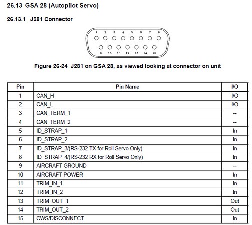

For control steering the installation manual says to use that switch to ground both autopilot servos. However, I don’t see what on the servos what the switch needs to ground.
CWS Input
Thanks for the info.
To activate Control Wheel Steering, you press and hold the AP Disconnect/CWS button. A momentary press of the AP Disconnect/CWS button disengages the autopilot.
Pin 15 on the J281 connector of the autopilot servo is where the AP Disconnect/CWS button is terminated on the servo side.
Justin
Can you Daisy chain the role servo to the pitch serval then to the Control steering switch for a single point ground?
That’s what it looks like to me.
