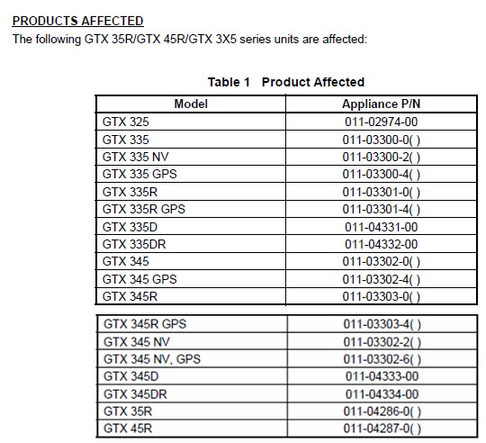

Hi Steve,
Unless the provided link is taking me to some other place, I am seeing this note in red.
"Notes:
This software update is intended to be loaded on GTX 3X5 Transponders only."
Or is it that 45R is part of the 3X5 family?

It says in 1.1 Terms: “The term GTX 3X5” includes all unit models.
When you download the app and look at the release notes there is a table that includes all GTX 325, 335, 345, 35R and 45R models
GTX Model List
Similar to the updates we offer for our certified Navigators, the Service Bulletin document we release alongside our transponder software update includes information related to the currently available software revision. From SB2179, which is included in the folder available for download here, this is a list of equipment for which this update can be applied:
