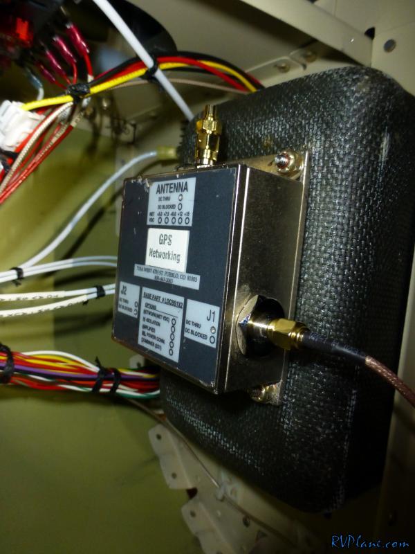

Too bad one can not share the signal from an existing antenna to multiple devices, like using a splitter type.
Oh but you can. GPS splitters exist and work PERFECTLY. I've been running a 1-2 splitter for over 2 years without an issue.
