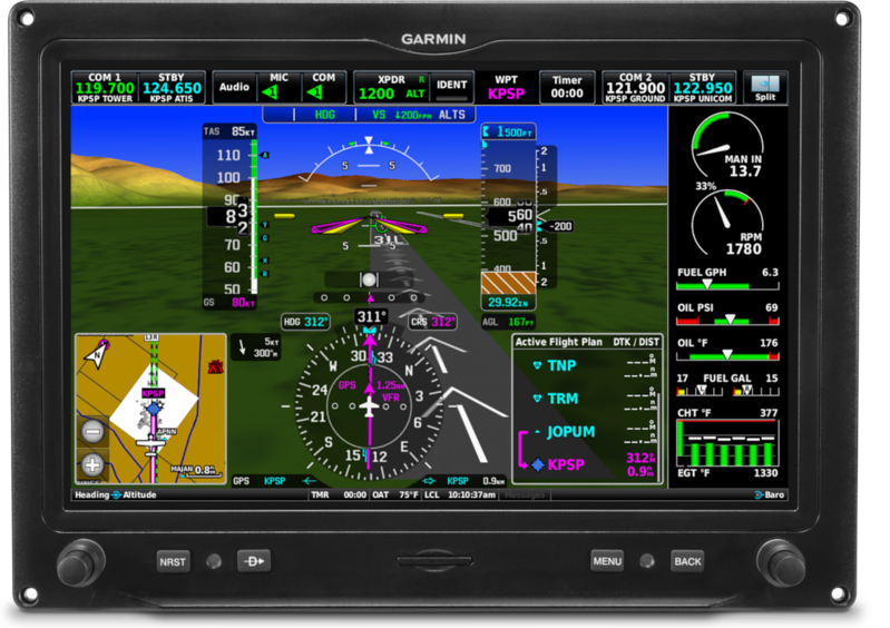

Greetings VAF!
We released G3X Touch Version 9.31 to the Software Download Area today.
This release includes the software support required for the GHA 15 Radio AGL unit. More details about this unit can be found in this post.
By common request, we have included the ability to determine and store a second set of AOA calibration values in the system in this update. This new functionality allows the installer to provide the system with the information needed to allow the AOA system to compensate for flap position. A flap position sensor, or flap position discrete input is required for a second calibration curve to be made available. In addition to this change, we now have an alternate AOA audible alerting scheme, more details can be found below.
In our last update we included a powerful new Advanced Gauge Marking Configuration tool. We have made a few improvements to this function, which are outlined below.

• Added support for GHA 15 radar height advisor
