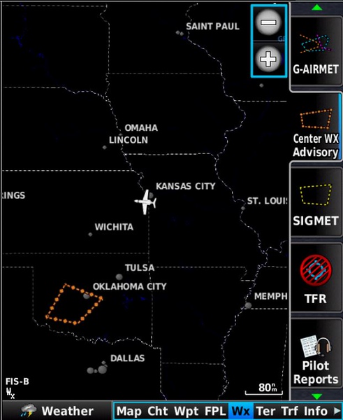

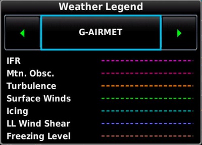

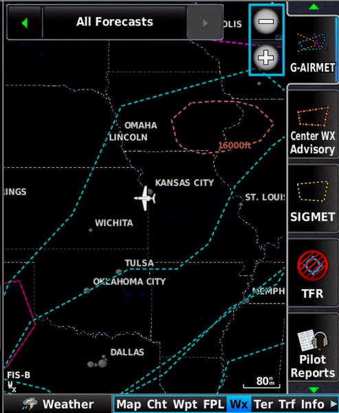

• Adds support for 2 additional FIS-B Weather Products, Graphical AIRMETS, and Center Weather Advisory. These are only available over a Bluetooth connection at this time. Serial datapath support will be included for these 2 newer products in addition to several others in a future update.
![GAIRMET-L.jpg](/proxy.php?image=https%3A%2F%2Fphotos.smugmug.com%2FSW-872-%2Fi-mZrgP47%2F0%2F1ed71cbf%2FL%2FGAIRMET-L.jpg&hash=346e1f31a5fb9f5c673ddbfd2c0d41fe)
![CWA-L.jpg](/proxy.php?image=https%3A%2F%2Fphotos.smugmug.com%2FSW-872-%2Fi-6Vs2V93%2F0%2Ff0aa80bd%2FL%2FCWA-L.jpg&hash=164e979a3cc58e6dbba96575b818e062)
![GAIRMET%20LEGEND-S.jpg](/proxy.php?image=https%3A%2F%2Fphotos.smugmug.com%2FSW-872-%2Fi-ZRbnDTn%2F0%2F59beba99%2FS%2FGAIRMET%2520LEGEND-S.jpg&hash=1e29da46d96bf146af0c3e5452f520c4)

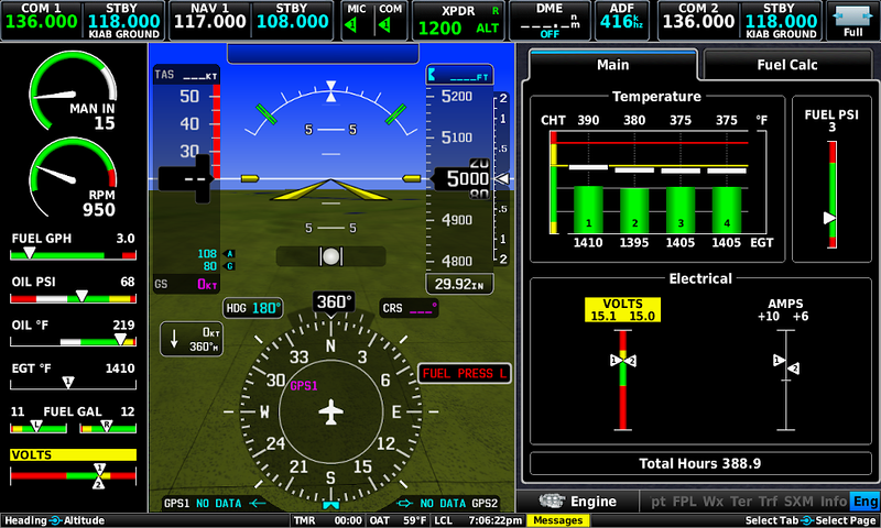

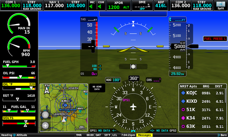

• A new EIS configuration setting can be found by selecting the Display menu in Configuration Mode. EIS / Engine Page Layout affects the behavior of the EIS Strip. When set to Combined the EIS Strip will remain dynamic, and the layout of the strip will vary based on whether or not the ENG tab is open. This is consistent with the way the system has operated in the past. If the setting is toggled to Separate, the EIS Strip Layout remains unchanged and does not respond to the presence of the ENG Menu. The system will default to Combined upon the completion of the software update.
PFD EIS Strip Display, ENG Menu Closed

PFD EIS Strip, ENG Menu Open, EIS / Engine Page Layout set to Combined
![PFD%20EIS%20Combined-L.png](/proxy.php?image=https%3A%2F%2Fphotos.smugmug.com%2FSW-872-%2Fi-DKVVXMP%2F0%2F8791427c%2FL%2FPFD%2520EIS%2520Combined-L.png&hash=b45e1bc740325e954360f977e270e907)
PFD EIS Strip, ENG Menu Open, EIS / Engine Page Layout set to Separate
![PFD%20EIS%20Separate-L.png](/proxy.php?image=https%3A%2F%2Fphotos.smugmug.com%2FSW-872-%2Fi-VwgmCvs%2F0%2F95d08c41%2FL%2FPFD%2520EIS%2520Separate-L.png&hash=66a3e1cc5d06cece08294b000978ba85)
