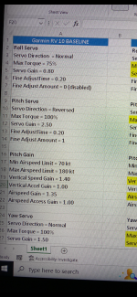

J Jesse23 Well Known Member Oct 18, 2024 #2 Are you looking for baseline values? There are many threads on this. The attached pic is a baseline start for the RV 10. G3X auto pilot servo settings Looking for the gain and torque settings for the Garmin servos that have worked well for you. Thanks! vansairforce.net Attachments IMG_6058.png 6.9 MB · Views: 39 Last edited: Oct 18, 2024
