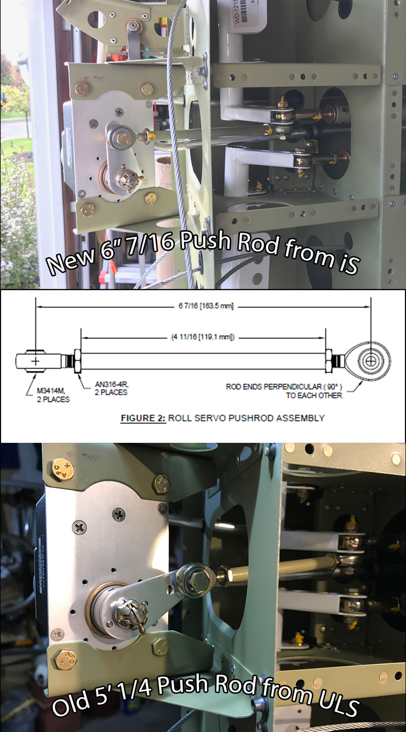

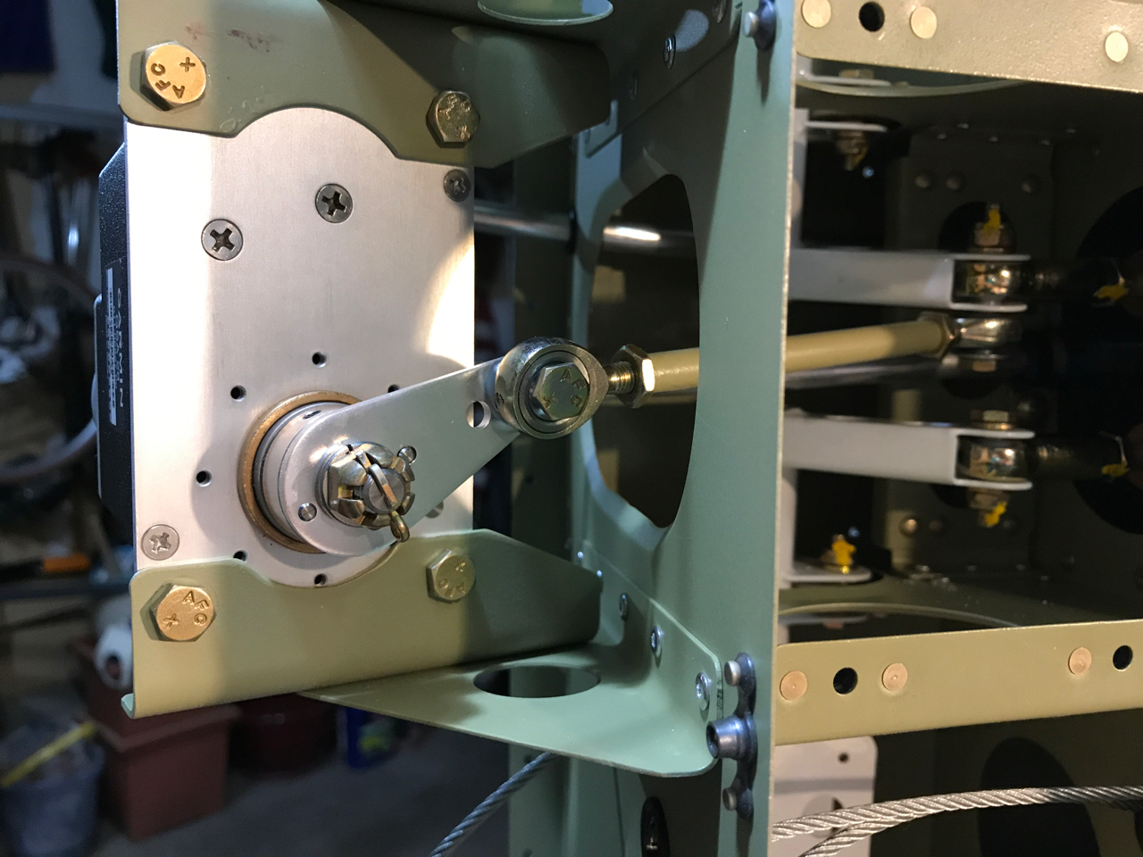

The pushrod that I made (5 1/4 inch) IAW 44B-02 dated 4/02/14 does not appear to be the correct length for the iS installation. I have tried to install the AP servo with the rod end this way but it is way to short. The stick is approximately in the neutral position. Guessing the geometry is a little different then the original ULS installation with the manual flap handle. I know there is no avionics plans yet available for the iS but maybe someone knows if the length of the pushrod for iS installation is different or the same. I have double check the rod length of all the other push rods and they check out good.
