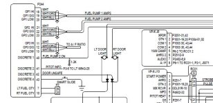

I have an application where I want to monitor lower amp draws and don't want to use a shunt that might get damaged rendering my fuel pumps inoperative. I want to use a hall effect current sensor. The Amploc Key100 seems to be the go-to sensor used (I have Garmin G3X systems). Amploc makes another series called the Amp and Pro25. I believe either will work? Anyone have any experience with them? I want to be able to understand if I have a prefilter (before the fuel pump) clogging (There will be a 1-amp reduction when that occurs) or if the post filter (After the fuel pump) starts to clog as their will be a 2-amp increase. Normal amp draw 5 amps. The PRO25 seems to have better sensitivity. I'm assuming I could loop the power line around the coil twice and change the range settings to further improve the sensitivity? Thanks
The G3X system is set up for Amploc KEY100 sensors, so that is what I would probably use since it is known to work. If you want more sensitivity for smaller maximum currents, you can loop the wire through a few times and adjust the sensor scale factor calibration accordingly.

I don't see why not. Although, now that I look at the manufacturer's datasheets, I think you actually could also use something like an AMP25 which would give you increased sensitivity. The two main constraints are that your sensor has to have a 2.5V output at 0A, and you have to know the mV/A scale factor. Not having tried it myself, I can't say for sure if it will work, but it seems reasonable.

My hall effect sensors (Key 100) are wired per the attached drawing and perform per the data sheet. I did need to wrap the positive lead of the fuel pump around the sensor 10 times to obtain the sensitivity I wanted but the set-up allows for this. Work well.
