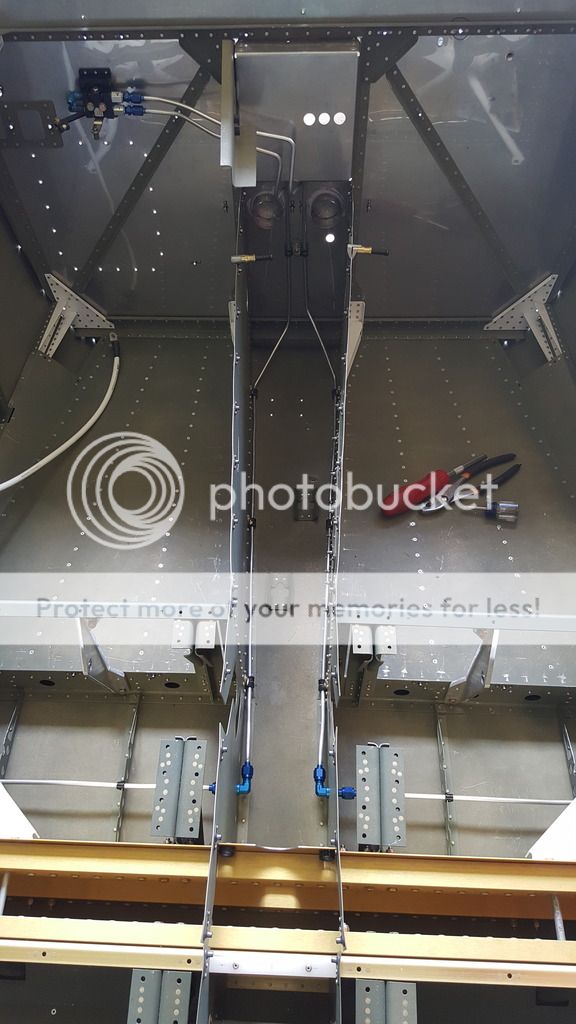

Just finished my brake lines and was feeling confident.

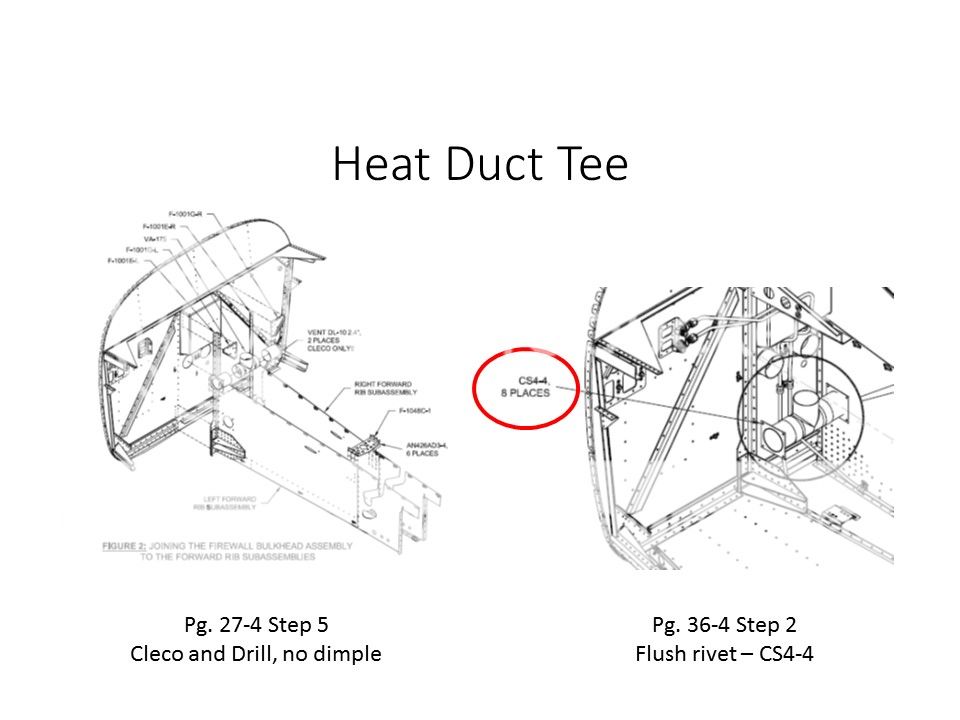

I went to reinstall the heat duct tee VA-175 when I realized the holes were not dimpled to accept the CS4-4 pull rivets called out on page 36-4. I rechecked the manual and can't find anywhere that tells you to do it (when it was convenient).
I know the easy answer is to just dimple and move on, but the location will only allow for a blind dimple (pop rivet tool). That dimple won't be great in the thicker tunnel material. The actual vent DL-10 is no big deal to dimple.
Did I miss a step or did everyone maybe use different rivets instead?
