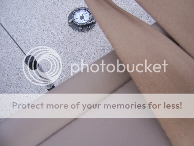

I have found the sight gage to be pretty worthless. If you use a piece of nylon instrument tubing you can sound the tank during preflight and verify the Dynon level. I marked my sounding tube during level calibration. It's flexible enough to negotiate the filler neck bend and stiff enough to give consistent readings.
This works very well - -
Can see while flying, and while filling. Both of these make it worth doing.

The extra Mollier gauge is just a supplement to it that some builders choose to add.
