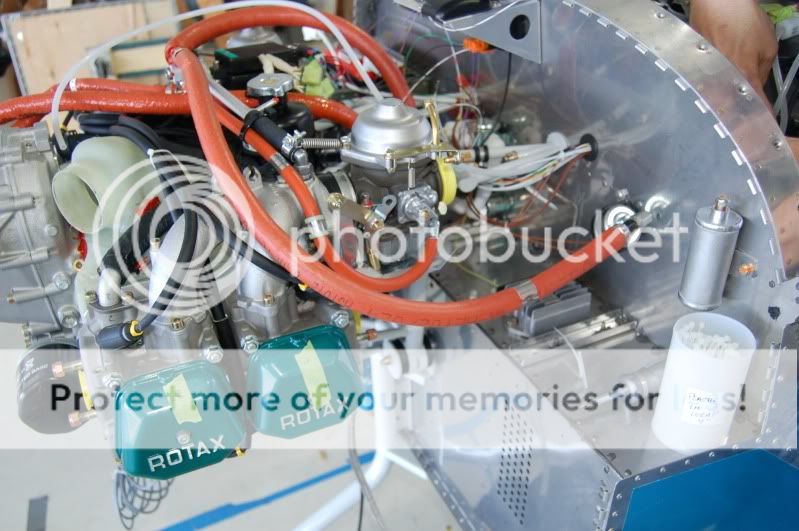

After fiting the hose and "clocking" the fuel sender (note that the description "4:30" disagrees with the drawing which shows "2:30) the pressure sender is not held tightly by the cushion clamp. With a little wiggling you can pull it out of the clamp, which doesn't seem good. Options I've thought of are:
1) bending the clamp somehow
2) wrapping the sender in tape to increase its diameter
3) gluing the clamp to the sender with RTV.
Anybody else run into this?
