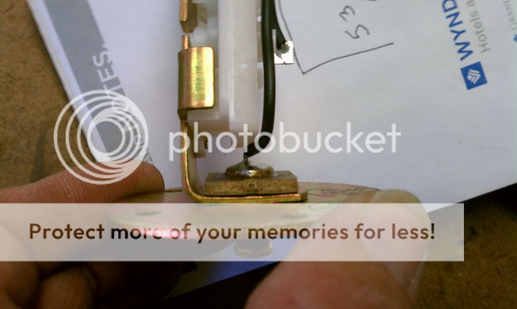

Has anyone else experienced this Dynon feature disappearing on them? (on main page 15 gal and less). After three years no less. If so, what makes it go away and can it be found somewhere in the caverns of the Dynon? Or does it mean a total repeat of the messy (and hazardous) calibration process as described in the Dynon Manual?

Tony, thanks. I checked Dynon and all appears in order. (No.1 main tank and it is turned on etc.). I did an ohmeter check on the sending unit in the tank (sending lead disconnected) and got no reading of resistance. I am not certain , but suspect this means sending unit in the tank is defective does it not? In thinking back to the first hint of a problem several wks ago the quantity shown remaining on page 1 did fluctuate between 7 and 2 gals while flying. The next time I went up the reading was zero and has been since.

BE SURE TO CHECK THE GROUND - -
several have had problems with that. Did you test with the negative on the airplane frame, or tank itself ?
There are two different fuel remaining values.
Fuel remaining as calculated by the fuel computer, and fuel level (remaining) displayed by the fuel level gauge.
If the problem is being caused by the fuel level sender it would have to be effecting both of these.
If you do not measure any resistance from the sender to airframe ground, check for good ground continuity between the mounting flange of the sender, and airframe ground.
To check the sender...
Measure the resistance between the sender center terminal and a point on the sender flange. Be sure to scrap a bare place on the flange.
The sender resistance varies between 30 ohms and 240 ohms. You should get a resistance between these values if the sender is working. If so then as the others say, check for the bad ground between the sender flange and the airframe. Others have had to run a ground wire from the sender flange to the airframe.

Thanks to all replies. I tested the ohms between the sensor wire center connection and the mtg plate, and there was no readout. Connecting leads to mtg plate and aircraft ground does show continuity. So I presume this is clear evidence of the tank sending arm failure to operate. Comments? Thanks.

The screw where you connect the positive lead to the sending unit has a very small solder point on the inside of the mounting plate. If when you installed the lead you turned the screw to tightly it is easy to break the solder point. Have you by any chance removed the tank lately?:rolleyes:
John, that's an interesting possibility, but I do not tighten the screw so m,uch as just snugging it. Pulled tank last time in Sept. of 2012. Failure occurred just a few weeks ago. Thanks for the feedback and when I pull the fuel level arm in Oct. I will check the solder joint to see.
