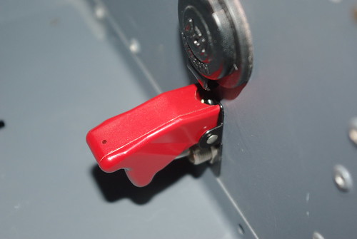

I installed the switch next to the valve. Just cut the red wire running to the pump. Installed an extra wire back to Skyview to indicate the status of the pump (see the red button between the stall and spar indicator).
Similar to Joeri, but on the vertical bulkhead just below the power outlet. I will typically leave the pump on as intended, but want the ability to isolate it if necessary.
Be careful, the fuel pump circuit also powers the two cooling fans on the avionics shelf. Turning off the fuel pump at the fuse position would also turn off the cooling fans- and that's not a good thing... :<)
