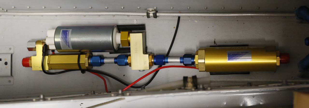

Today's agenda is to install the airflow performance pump and filter. When I start laying it out I see that the combination of the two is much longer than the old pump and filter. The mounting brackets already on the floor of the tunnel are to close together. Before I start drilling and moving the pump bracket, are there any better answers? I see that vans now sells a "10 F.I. PUMP KIT" that it says contains items to make this install easier, any idea what the contents are, I know I could call tomorrow, but was hoping to get this done today.
