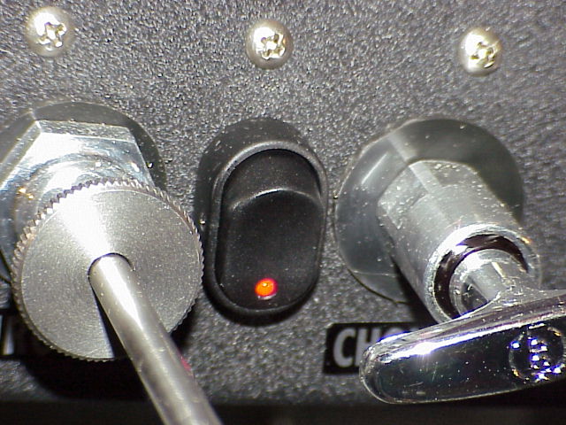

I added a switch for the electric fuel pump. I just don't like having it running all the time and the SB supports my caution. It's a good thing to be able to shut it off. There is no need to have two fuel pumps running at the same time, all the time.
Fuel Pump
Simple Check of your Serial Number will show if this applies to your Engine. It does not apply to mine which is S/N 5652556.
