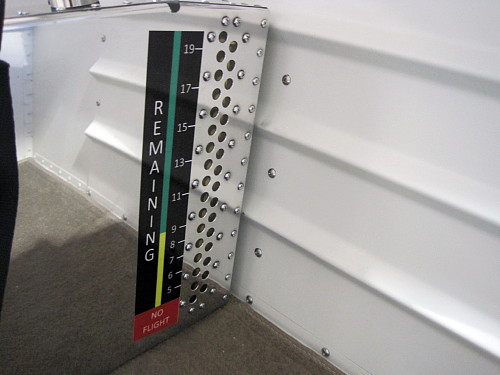

Here's a shot of the graphic I made for the side of my tank. Just FYI for us old "sight glass" tank owners.:)
Nice sticker Randy, but I am concerned if you are actually referencing it for minimum fuel for take-off.
It looks like when you installed it you positioned it too low. The four gallon indication is when fuel is mostly covering the third window segment from the bottom. It looks like your label indicates lower than that.
Geez, I'm surprised my wings haven't fallen off (countersunk wing rivets under the wink walk) by the time I've run out of gas!! :rolleyes:
I was pretty anal about measuring the fuel. On my tank with the airplane level, the right most sight glass circles equal even gallons. So my sticker is placed correctly.
However, I will double check it the next time I get the fuel down that low. I may have made a mistake. I would never take off with the fuel that low in any event but it needs to accurately reflect the proper fuel level in the tank so thanks for pointing this out. I had two of them made at the vinyl shop so it's an easy thing to peel this one off and install the other one.
Sorry Randy, I didn't mean to induce defensiveness or sarcasm.
It is actually an important detail, which is why it was well documented in earlier plans pages when the sight window was being used. Early Section 51 pages have a detail that shows where the label should be located, and I think the PAP may have also specified to fill the tank with 4 gallons and place the label accordingly.
If you installed it using that technique, then I guess you are fine.... but it looks lower than any I have seen. So, my post was in the interest of the safety of a fellow RV-12 pilot. This is after all just an internet forum.... you can take it or just ignore it.... your choice.
