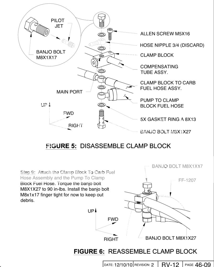

Fuel Leak at Banjo Fitting. I'm following the PAP (see p. G4-1) at this point and testing the fuel system for leaks. Everything looks good except I have a leak at the banjo bolt (M8x1x17, see 46-11 fig.2). It is torqued appropriately according to plans and verified in the Rotax illustrated parts manual. Neither the KAI nor the illustrated parts manual call for sealant, but I'm wondering if I should be using something like loctite 567?
Have others had leaks here and if so, what did you do to solve it? Thanks in advance for your suggestions. I'm going to go get a hamburger now. Slane
I don't have access to the KAI right now but I assume you are talking about the banjo bolt for the fuel pressure/return line.
What can happen is the 2 banjo bolts can contact each other inside the block before the second one fully compresses the copper gaskets while being torqued. Rotax recommends that new gaskets always be used when assembling. They usually work for a second time but not always.
I wouldn't recommend using any sealant... new gaskets would be the right way to correct it. I guess another option would be to remove a small amount of material from the end of the bolt and try retorquing.

I'm going to try taking a very small amount of material off the end of the banjo bolt. Question: Does torqueing the copper gaskets compress them and they have no elasticity after this?

It is not a matter of elasticity, just that copper is soft so they get slightly thinner each time they are torqued. That is we Rotax specifies new gaskets be used each time.

Slane, take a moment and review the plans to make sure that you have all the copper washers installed in the right places. Also be careful not to over torque the banjo bolt, a few guys on the form have broken them off. :p
