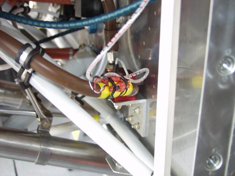

Brian here is a photo of how I mounted my fuel flow transducer. It works great here and was very easy. Just need to have youe hose split and new ends put on.

Geoff, is that your flying configuration? I thought the Flo-Scan documentation said the cube has to be fire-sleeved when mounted Forward of the Firewall.
And....
I know this is an old thread, but along with Mark's (Charliewaffles) question about firesleeving, I thought EI also recommends you don't mount the red cube FT60 on the engine due to excessive vibration. Has it been successful in this location Geoff?

Good to know gents. Given that I've already fabricated the fuel lines in the tunnel without the red cube (since I planned to place it FWF), I think I'll continue with my plans. I've dug up 7 installation photos and everyone seems pleased with the FWF location (except the gentleman who installed it with rigid aluminum tubing and had a fuel line failure leading to an engine failure).

Here is where I did mine and it works great! I copied someone else. Brantel I think.
My instructions stated to firesleeve the red cube so I did.
I thought my instructions said not to mount it rigidly to the engine... The vibration will be very hard on the bearings inside it. I just finished working out the permutations of hose and mounting that would let me add one to my -6, i'll try to take photos tomorrow to show the location. [edit - just noticed this was the -10 forum... My mounting may give others ideas though, so i'll still post pictures when I get them.]
