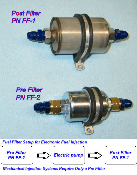

Here's a photo of our installation of the Aircraft Specialty kit. I'm enthusiastic about this because of a few reasons. From a safety perspective, there are two filters. So if one tank becomes contaminated, the other tank will still flow fuel. Second, the complexity of the fuel filters are not in the cabin, so if anything leaks, the leak is overboard. From a convenience perspective, servicing the filters in the wing root is so much easier than in the tunnel.
there’s a thread about loss of power due to the facet boost pump getting trash, this boost pump does recommend having a pre filter. Im not the builder of my 6a so I don’t know if the fuel pickups in each tank have screens or not.

I installed filters in the wing root of my 7. The Facet pump, as mentioned in a previous post, requires a pre-filter. I didn't want to have the filter in the cabin for cleaning with the resultant fuel spillage, which is why I installed them in the wing root. When cleaning I just tape over the vent and close the fuel shutoff. After disconnecting the filter I put a plastic plug in the tank side fitting to stop any leakage while cleaning the filter. Very little fuel leakage as long as the fuel cap seals are good. I always put a sticky note on the plane so I won't forget to remove the tape on the vent.
This is exactly my thought was on servicing, cheers Rodney
you recal what filter you used and mesh size?
I got them from Summit Racing. It was the Summit brand 40 micron AN6 filter.
