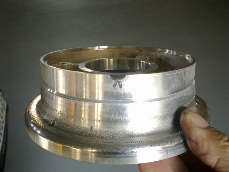

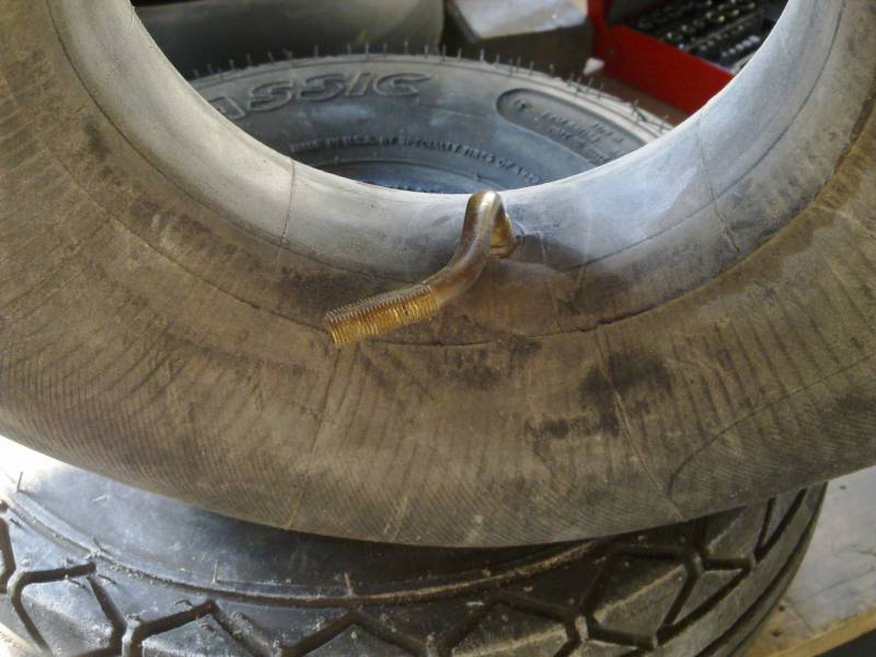

After a lot of searching and help from others (thanks Eric) I have ordered a Leakguard tube. BUT discovered that the stem is exactly the same as on the tube that came with the kit.
I have decided to have another try at solving the problem, using the supplied parts that one gets with the kit.
Step 1: Use a small tubing bender and bend the valve stem more or less as indicated in the picture below.
Step 2: Using a round file, file away the rim as shown. Look for the “V” mark as this will be opposite the half round already taken away in the other half. By doing this the stem will come through the rim without bending sideways.

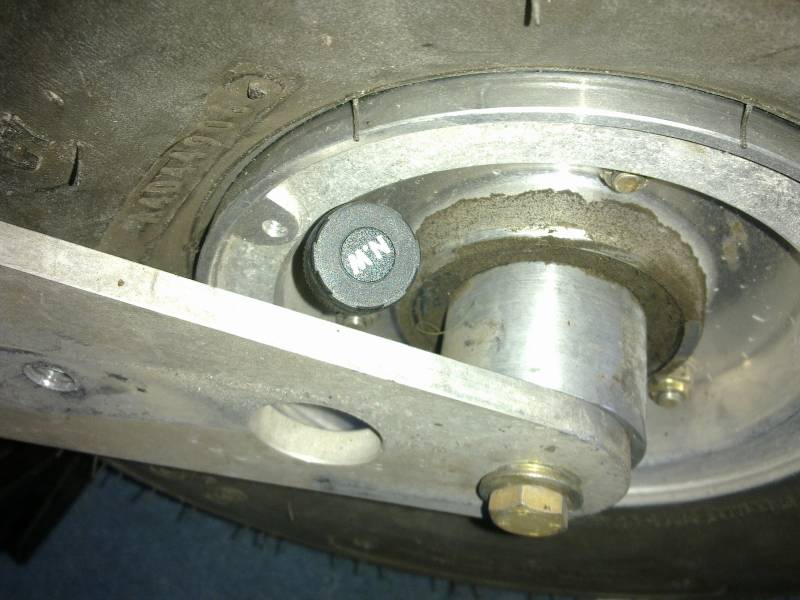

Step 3: Enlarge the stem hole on the other rim half in order for the bent stem to go through easier. Assemble and inflate. Below is a picture after installation. Note that even the much bigger SPC sender unit has clearance with the fork.
