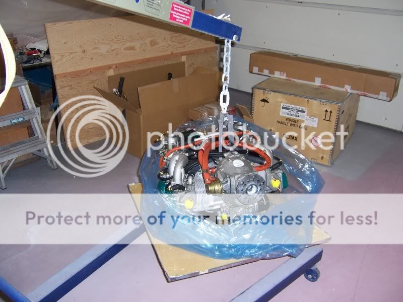

My firewall forward kit shipment has been delayed and I'm in a bind. We have reservations and need to head South. It will be necessary to have the kit delvered to my Son's house; two hundred miles from me. He plans to pick up the crate from the loading dock in his PU truck. He will need to unload the crate out doors at his house, and bring the pieces in seperately, through a standard 36" doorway, to be able to store it indoors for me, until we return.
My question is regarding the engine crate itself. I don't want him trying to get the engine out of it's crate. I remember reading about Marty, who had difficulty and wound up with stitches over it. So, how is the engine crate secured to the inside of the larger shipping crate? I need to guide my son in separating the two, to allow him, and a helper to carry the engine into the house for safe keeping. Hopefully, someone will remeber.

Tom, I think it was bolted to the bottom. You have to remove the top of the engine crate once all the other things are removed, then unbolt the bottom of the engine crate from the larger crate, then you can re-assemble the engine crate. I think that is how it was. Maybe others can correct that if I am wrong.

Best Picture of engine crate
Hey Tom,
Went back and found this picture. If you look to the left, you will see the actual base, and the blocks on it that held the engine crate in place. You can see the top off of the engine crate to the right also. Hope this helps.

The photos in my blog show how the crate for the engine was attached to the larger shipping crate. There were cross members (2x4s) holding the engine crate in position.
http://martysrv12.blogspot.com/2009/08/engine-kit-arrived-today.html
Marty, I understand that the 2X2 cross members were holing the engine crate in position, within the larger shipping crate, Was the bottom of the engine crate bolted to the bottom of the larger shipping crate, or could you have lifter the engine crate out of the larger shipping crate, after removing the 2X2s?
Thanks, Tom
As I recall, the bottom of the engine crate was NOT screwed or bolted to the bottom of the shipping crate. The engine crate is quite heavy. You will need an engine lift/slings (or four helpers).

Hi Tom, Here are a few notes that might help.
The 4x2s hold the engine crate down and prevent sideways movement.
The base of the engine crate is not screwed down to the big crate, but a cleat at each end is screwed down to the big crate and stop it moving.
I started to take the top off the engine crate, but soon discovered Vans had cut all the metal tabs around the bottom of the engine crate, so it was already free and just has to be lifted off, top attached to the sides.
The engine is not that heavy, including the plywood base of the crate. It was fairly easy to lift one end of the engine crate base and slip under one of the 2x4s. Same the other end. Then a friend and I easily lifted the engine out of the big crate and placed it on the top part of the engine crate, which we had placed beside the big crate.
In the engine crate is a bundle af accessories, taking up about a quarter of the length of the engine crate. They are held with a cardboard strap that is easily cut for removal.
