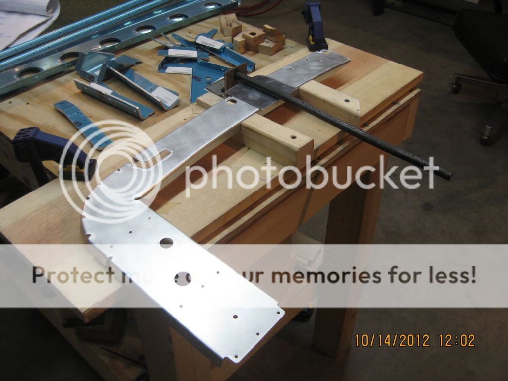

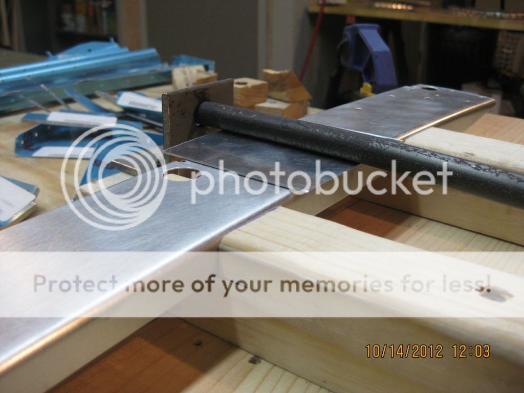

Bulkheads
I had this problem on the -8. The inside curve of the bulkhead flange makes the bulkhead curve towards the toe of the flange. In other words, the flange doesn't need fluted, it needs stretched. This is how I did it. This technique resulted in nice straight bulkheads.
