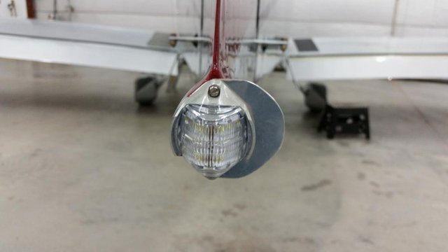

8 hours into Phase 1 flight testing. It looks like I will need a trim tab to center the ball in flight. I am going to do a "fixed tab" on rudder trailing edge. (not looking for advice on electronic or spring actuated options).
Does anyone have pictures of their fixed rudder trim tab they can post for me? Looking to see how big you made it (dimensions) and how you attached it (rivets on trailing edge only, rivets on stringers, ProSeal, etc...)?
I used about 14" or less of the triangular shaped stock that is included for rudder/elevator trailing edge. Currently held on with Al tape until I paint it and affix it with silicone. I pretty much aligned the thick end with the rudder trailing edge and was sure I was high enough to be in un-disturbed air flow
A thicker wedge, with a greater angle would be shorter. I like this one because it blends in very well, even though it is long. The wedge on my 6 was affixed with silicone and is holding strong after 650 hours.

Here is a simple tab if you just need a little. Easy to try without anything permanent done the rudder.

Here is what mine looks like. I too purchased the one from Cleveland and it works really well. I attached it with proseal.

I have always liked the trim tabs on Tomahawks. It is a piece of maybe 22 gauge about 5" tall and extending 2' past the rudder trailing edge (5"X 3" actual dimentions is my guess). It is rivited to the trailing edge (could be pro-sealed). You can then bend it to adjust trim. If something changes in your trim or flying, it is easy to re-adjust.

No. A fixed trim tab is generally set to put the ball in the center at your "typical" cruise setting. All other conditions (climb, descent, slow flight, etc) will require some rudder input.
