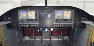

Can someone please post a link to a picture or post a picture of what this finished panel looks like? I’m looking for the details on the finished color and exact text it’s that’s screened.

This is the photo Van’s has on their website for the pre-made 12iS panel. I assume Van’s or Steinair could tell you what the color code is for matching.

This isn't silk screened. It's printed on Carbon Fiber Vinyl.
I wrote an article for Kitplanes.
It's actually a pretty cool process. The idea is to create the CAD layout first. The file is then turned into a SVG file and printed. First print is black line on white. Apply it. Cut right through it. Peel it off. Clean up. The final skin can be printed on whatever you want. Apply it. Since it's all based on CAD, changes are easy.
