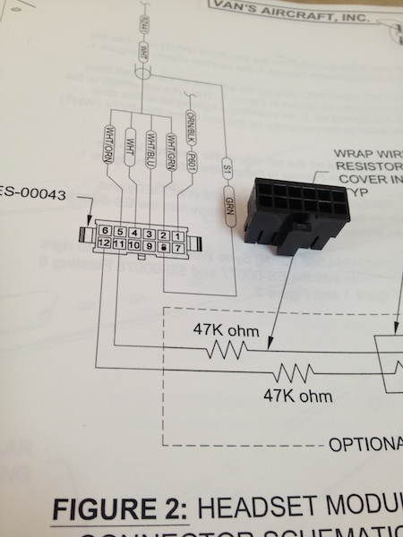

Step 1, insert RZ441 Co-Pilot Headset Wires and WH-P601 (orange black) Audio Power Wire into a ES-00043 Molex Receptacle.
If the wires mentioned above are inserted in the male molex as shown in Schematic Figure 2...they do not match the same color coded wires in the female molex when connected.
Should I simply insert wires from the harness into the male molex connector in an arrangement that matches the arrangement in the female molex.
If so, there are three white wires in the molex connector attached to the phone jacks and only one solid white wire included in the above group...from the harness. Which two white wires in the existing molex should not be used?

Today I ran into the same color missmatch problem doing my jacks on a recently delivered finish kit. I wound up downloading the RV-12 schematic drawings from Van's to take a closer look. My personal opinion, based on what I see in the schematics, is that figure 2 on page 31B-17 is incorrect. I rewired the loom side of the Molex per the schematic since it appears to be correct. In other words, I lined it up color for color. If you look at the individual pin functions, it makes sense that way.
Alex
Just to clarify the above, if wired per figure 2, the microphone hot and ground leads are reversed, the left and right audio channels of the headphone are reversed and the headphone ground (shield) is not connected at all.
Alex

wrong gender connector? wrong orientation?
Here's my $0.02 on this page. I think the connector I have in my hand is the wrong gender compared to the instructions. The diagram in the instructions show "ears" which correspond to the connector I received with the jacks pre-wired into it, not the connector I'm trying to use.
Below is a picture of the Micro Connector I received in my kit. Looking at the photo, pin #1 is in the top left spot and #12 is on the bottom right.
If I turn the diagram around (e.g., swap #1<-->#6, #7<-->#12) then the instructions (colors) match up to the ones in the pre-made harness, and there are wires on both sides of each connector that match (expect for the optional power.)
Another way of stating it: the caption "(VIEW FROM WIRE INSERTION SIDE)" is in error and the image provided is the view from the pin side of what we're supposed to insert but is correct for the connector in the supplied harness.
How have those of you who completed this page interpreted this drawing? Am I trying to use the wrong connector even though it's the correct gender for the pre-wired harness?
Thx,
My take and I didn't sleep in a hotel...
The wires depicted in the drawing above go through the top and bottom of the shell. To me this means that drawing is showing the top of the connector. Your picture of the connector is the bottom of the connector or where the pins slide/insert in.
You have the correct part just 'turn er over'.
Bob
Hi folks, after reading the above, I managed to download the RV12 schematic, and then found "Draftsight" on the internet to search the Copilot Headset wiring. Figure 2 on page 31B-17 is definitely INCORRECT, - it shows the pin insertion side of the ES-00042,(the one with the ears) which is the female socket prewired to the Mic & Headphone jacks, making up the Headset Module ES-00147(CoPilot). If we wire the male plug ES-00043 as per figure 2, the wires do not connect to the corresponding ones in the ES-00042, and as mentioned above, several wires are crossed, & the barrel or sleeve of the headphone jack is not connected to the shield wire on the harness as it should be. To wire the ES-00043 correctly, the pin numbers must be transposed laterally, (pin 6 becomes pin 1, pin 12 becomes pin 7, etc. The function of the wires & the colours then match up correctly. I am thinking there must be large numbers of '12s wired incorrectly, so the system must work to some extent, but the wrong wiring probably does lead to the "gremlins" & extraneous noises some have been experiencing when mixing headsets, etc. Cheers, DEAN..

Having just installed an ADS-B unit with a number of DB connectors I took great pains to avoid a mirror image wiring error. The convention on DB (and probably all connectors) is that if you are looking at pins pointing at you the convention is numbering left to right. If you are looking at sockets pointed at you the numbering is right to left.
