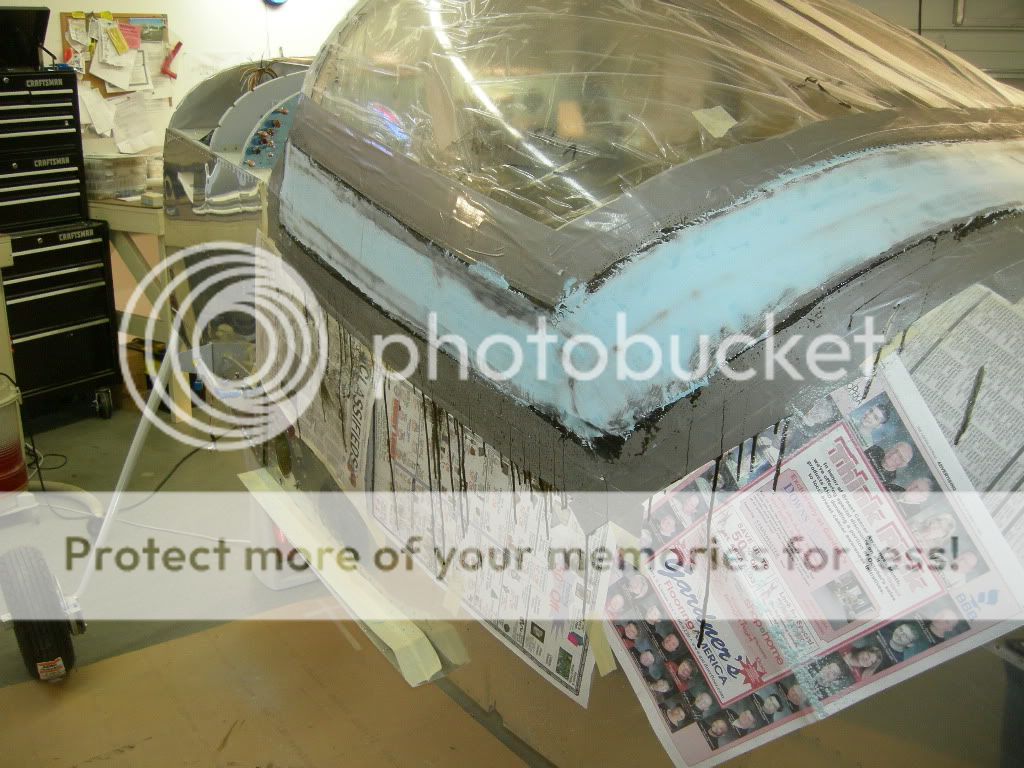

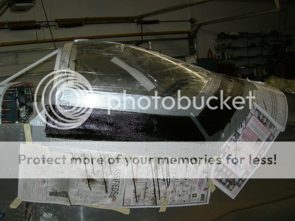

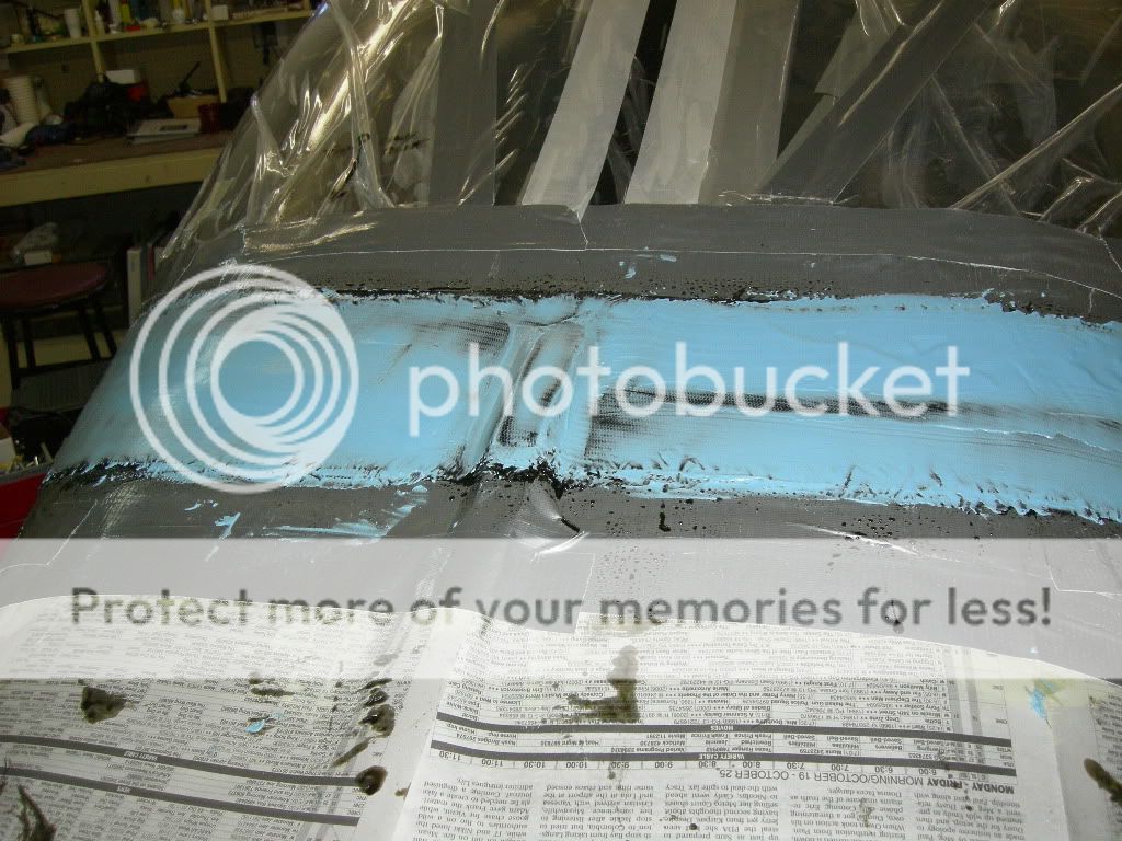

Hi Kyle,
I agree, there is a lot of good posts on fiberglass via the "searches". For my canopy skirt, I added two layers of bi-directional carbon fiber cloth for stiffness. In flight, the canopy skirt will tend to bow out from the fuselage sides. The carbon fiber adds a tremendous amount of stiffness to the layup. I bought about a 20 foot roll of remnant at a discount from a carbon fiber store online. Added a black pigment dye to the epoxy to match the black color of the frame. Maybe a little more info than you asked, sorry.
