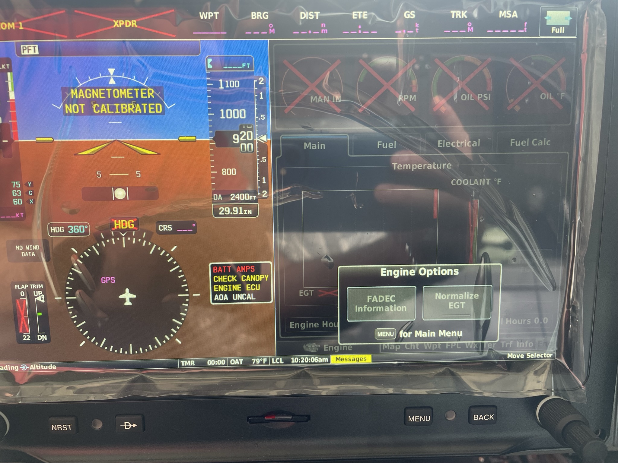

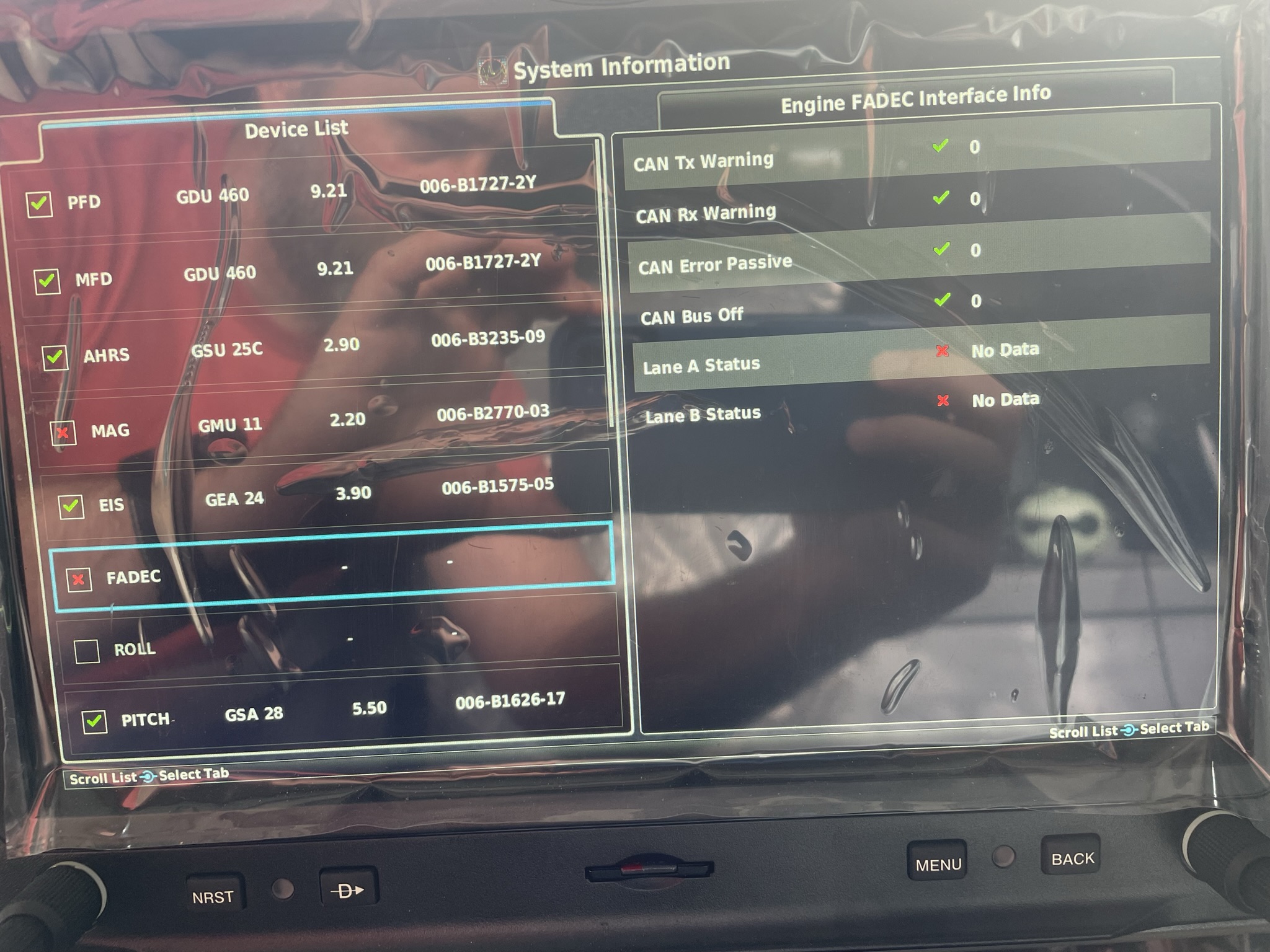

Pretty sure I have a call to SteinAir in my near future, but hoping someone could suggestion additional troubleshooting steps I can try today. I'm seeing no data from the FADEC & isn't showing as detected. EIS appears to be operating normally (flashing green light). HIC is showing a solid green (or maybe yellow) light.
Steps I've tried:
1. Verified grounds to fuse box
2. Verified all fuses (both on power module & in fusebox)
3. Verified continuity to Power X3 from HIC
4. Verified continuity to GEA24 via pins 1-> 17 & 2->33
5. Reloaded config in GDU460
6. Verified continuity on the 2 FSP pins & 1 SBB pin on HIC d'sub
Anyone ever seen anything like this before?
Any additional troubleshooting steps anyone can think of?
