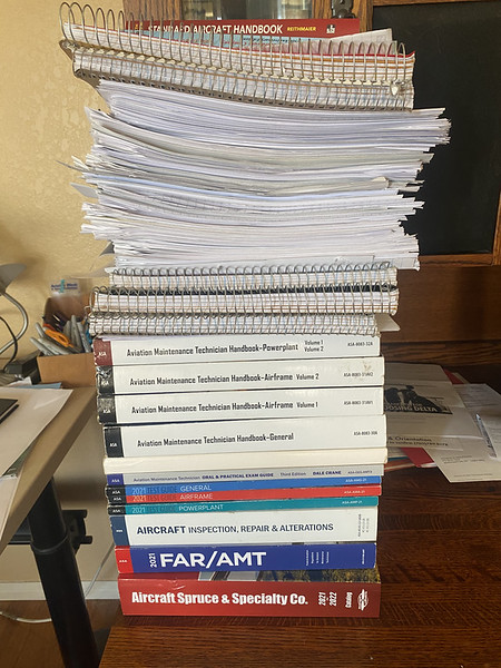

As someone who just finished up 2.5 years of full time night school getting my Part 147 Airframe and Powerplant credentials, let me just say that building an RV will get you probably at most 10-20% of the knowledge you'll need to have to actually get the A&P rating.
Here is just a portion of the material I had to study.

That is funny, Bruce. Yep, went to the same school - Miramar College, right? Haven’t seen that pile of books in awhile though, good laughs!
The ACS catalog? :D

The ACS catalog? :D
Yes, actually it was a part of our "reference" material for Miramar College. Lots of good information in the catalog on types of AN hardware, materials, wood, and costs for estimating overhauls and repairs.
That's what I figured, but it does look a little funny sitting along with the other study materials.
