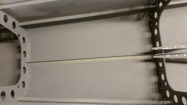

Dan,
I did not like the long run on the bottom skin between F808 and F809 ribs. On both the RV-8A and RV-8 I added a 0.032” 3/4”x3/4” angle between the two bulkheads and riveted to the bottom skin. I have a bracket to attach the angle to each bulkhead as well.
The RV-8A has ~1400 hours and all is well.
Carl

Your configuration - IO-390, Hartzell BA prop? That configuration is probably not that common, although I know that Vans has approved the IO-390 on the -8’s. Might not find that many similar examples with your flight hours/experience. I remember early RV’s with thin skinned elevators and rudders (.016) having issues with cracks and smoking rivets, attributed at that time to prop pulses from higher horsepower prop pulses. The remedy was .020 skins on those surfaces - I think. That may not be your issue, but I liked the idea from Carl, to add an angle belly support between the F808 & F809. Might be an oil canning issue, which the stiffener would resolve.

This was going to be my recommendation for an improvement. I think regardless of exhaust, there is a tendency for that panel to oil-can. Even more so on the RV-7, I've seen it.

If retrofitting such a stiffener to a completed fuselage, what would be an effective method of dimpling the skin? The skin is too thin I guess for machine countersinking, and the pulled rivet tool dimplers make a dimple that is a bit on the shallow side.
Question: Would an angle similar to Carl’s extending between the bulkheads and pro-sealed to the internal fuselage surface solve the oil canning issue?

Something is working that skin. If the cause remains a mystery, I'll just proceed with a stringer and monitor it going forward. Carl, Steve, thank you for the suggestion.
Me like. Should work fine for the skin, and it's easy to fab a good tie to the bulkheads.
Seems like the perfect spot for pop rivet dimple dies on an assembled airplane.
Not absolutely needed to rivet this stringer. It would be better yes, no question. But if you glue it on with scotch weld or pro seal or even 3M VHB tape ... this would already dampen/reduce/stop the oil caning situation.

I'm probably going to copy this idea. It's easy to see what you did to attach it to the 809 bulkhead, one rivet in the middle. What I can't see is how you attached it to the 808 bulkhead. Mating it up with a rivet that holds one of the the baggage ribs (F-818) to the 808 bulkhead would be easiest.
I vaguely remember this coming up when I was building my 8 20+ years ago, with the problem being oil canning. IIRC gluing stringers in place was one solution. Wouldn't hurt to throw a few rivets in there just to be sure that thing doesn't pop loose and get into the pushrod.
