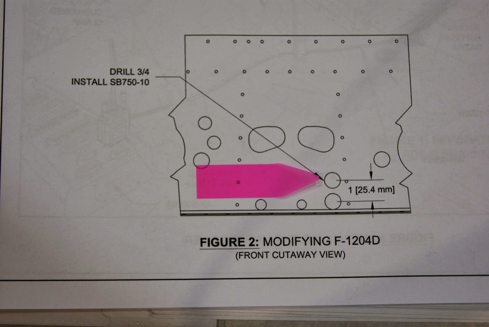

F-1204D hole placement
Jim ? Below is a photo posted on my Blog March 29th 2014 showing where the wire grommet hole needs to be located on the F-1204D bulkhead.
Additionally, you may also need to drill another wire hole in your F-1202B instrument panel base. Mine only had two wiring holes and three are required now ? which is why I?ve included the Blog post date because I also have a photo showing the location for that hole as well in the same Blog posting.
Hope this helps ?Happy Building,

John, Thanks for your response. This throws up another issue I was not aware of but from your blog I believe this relates to the ADSB option and Section 53. I will follow this up and hopefully drill necessary holes for this option as I did for the Skyview update.
HOWEVER, this is not the issue I'm trying to get info on. I'm talking about the main centre section channel with bulkhead attached F-1204. On early models (of which mine is one) there was a hole missing and another undersized. As per my previous post there was apparently a drawing issued by VANs to correct this but I do not have a copy.
I'm also a bit concerned there may be knock-on effects from this on the F-1204D and F-1206A bulkheads.
Copy of your Section 53 pdf would be appreciated anyway. (nilved(at sign)globalnet.co.uk)

Jim- I thought the Figure 1 drawing for the additional grommet hole placement on the F-1204A was also there. My bad ? mine had this hole, so guess because it was not an issue for me I did not post a photo of it ? thought I did. Will send you the section 53 ? you will need to look at figure 1 on page 53-03.
Any way, you have mail.
