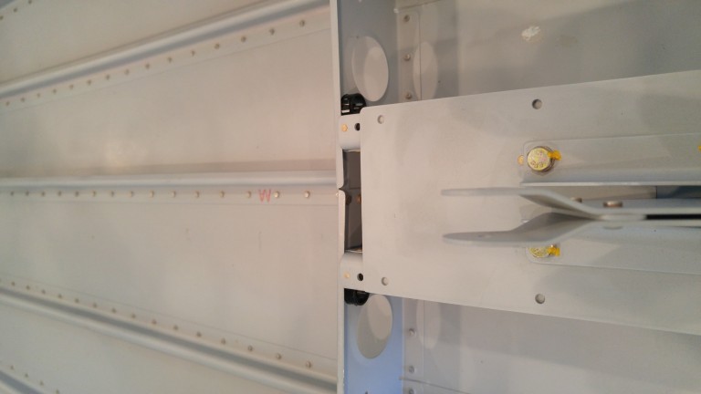

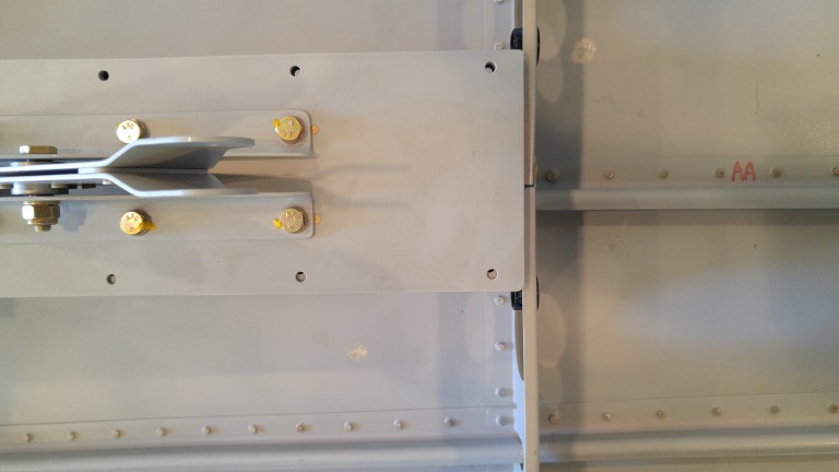

I riveted F-1029L&R per Page 10-21 Step 3 and when I tried to test fit F1035 (the elevator bellcrank mount) to it, I found a bad misalignment between the holes in F-1035 and the F-1029 pieces, at the aft end. The bellcrank plate and F-1007 were completed by the previous builder of this tail kit. It looks to me as if F-1007 and F-1029L&R were all pre-punched and so I'm at a loss as to why this misalignment is occurring.
This looks to me to be too much to try to squeeze the 1029 pieces towards each other to make it fit.
Has anyone else had a similar problem? Any thoughts?
