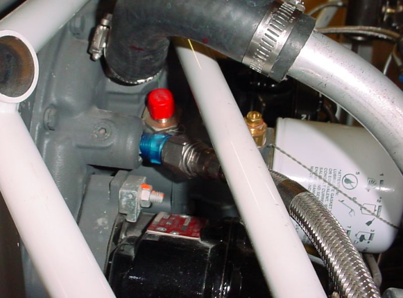

Busy with all the engine installations and I am wondering what hose to connect where you see the red plastic cap in the picture below. As far as I can see I have connected everything I should, including the oil cooler. Thanks.

Sorry - not on the IO-540. You can see the brass oil temp sensor just to the right and next to the oil filter. Below the cap is a hose fitting and not a threaded hole for any type of sensor. I should have mentioned that.

Finally one I can answer. I poster the exact same question last summer. My engine is an io-540 ordered through Van's. It's an alternative oil line location. You use one location or the other. Van's recommendations for oil lines end up having this one plugged. Some alternative builders already have plugged this before delivery.
Do a search for the thread as titled below. Thread started by tomhanaway.
I ended up with the brass threaded male fitting with AN plug. Not flying yet but looks very solid.

So I will order one AN929 6D cap from Spruce. Seems to be a good solution.

This is also the location for the oil bypass valve used in conjunction with the oil screen housing. Not used when the filter adapter is installed. As stated above "plug it"
