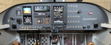

I was able to run the engine a few days ago, also calibrated the fuel gages. All sensors, but for that ammeter mentioned above, working good.
The install is now complete, and not really a surprise, took twice as long as anticipated.
Skipping Stein and doing one's own wiring, removing the E.I fuel gages, rewiring some of the stuff, configuring and programming, all of it very satisfying, but somewhat time consuming.
The finished product below...
A few final notes re this upgrade, now that all works :)
The nice sensor compatibility list from Garmin is basically useless if one doesn't know which sensors are installed, which was my case. Identifying those is not always easy...
Eventually I had to replaced the oil pressure, oil temperature, fuel pressure, MP, and ammeter (hall, now Ampac KEY100) sensors.
The configuration and programming is quite time consuming, using an external power supply a requirement.
On my first take-off all CHTs shot thru the 500°F limit, and sure enough I later found out that the VM CHT probes are of J type, whilst the EGT are of K type.
My old Floscan 264 works, but obviously indicates way too high, and will be replaced at the next opportunity with a standard red cube, part of the sensor kit.
The fuel calibration takes some time to perform, the more so if smaller increments are used (I used 5L), which improves accuracy. On a taildragger to be done in flight attitude first, and later in ground attitude.
Better be sure to have an uninterrupted access to the pump ;)
