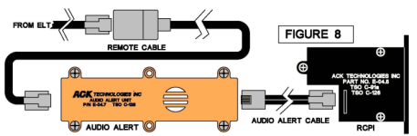

After triple-checking the wiring, installing the batteries, etc., I'm getting a ticking sound from the speaker in the small enunciator box zip-tied to the main unit. I also have a flashing red light on the little unit on the instrument panel. Any thoughts would be appreciated.

Check the plugs on the cable going to the remote on your panel by comparing them to the long cable that came with your ELT. My harness as it came from Steinair had one of them backwards causing the problem you’re describing.
I had the same symptoms with mine when I first installed it. Both the clicking and the light. In my case, I had to extend the (telephone) cable about 10 inches from what was supplied by Vans due to my placement on the remote in the panel. I used a connector and a short piece of cable to extend. Found that the problem was with the connector that I had used to extend the cable. When that was replaced, the ELT worked fine. Suggest that you try another cable and connect it to the remote to eliminate that as the cause.

The ACK E-04 installation diagram is shown below. In my RV-12 what is labeled "Remote Cable" below was just sort of extraneous with the extra length just wrapped up. My Audio Alert Unit (AAU) is near the ELT. The long cable to the panel is the "Audio Alert Cable". I figured I'd get rid of the short "Remote Cable" and just plug the ELT directly into the AAU. Wrong! It turns out all the parts shown need to be used and in the order shown below, include the shorty (in my case) Remote Cable.
The ACK worked when hooked up using only the black cables supplied with the unit, bypassing the Van's-supplied long grey cable from the remote back to the ELT. Turns out that long cable from Van's is "crossed" when it needs to be straight through. I now suspect that the short cable and female/female connector shown in the KAI which people are tempted to delete un-crosses the long grey cable going up to the remote. I must have lost the short cable from Van's and used instead the short black cable in the box which is straight through. I think I can fabricate a new short, "crossed" cable to make it work.

Maybe I am reading the KAI wrong but it seems to be at odds with the ACK instructions.
This is NOT what the ACK documentation shows. Mine only works when I have it connected EXACTLY like it is shown in the ACK manual.

the short black cable does un cross the wires, I was working on a friends RV8 installing a new ELT, I needed to use a double female end fitting, after installing the ELT it did not work, I noticed by adding that piece and plugging in the male connectors to that the wires (phone cable) were reversed , the wires are colored so I bought a phone cable splicer and installed a new male connector making sure the wires were now matching up.
My short black wire was straight through. I bought a $2.00 coupler which reverses polarity and that fixed it. So I wired it exactly as described in the KAI but swapped out the coupler provided by Van's with the reversing coupler.

It through me off at first, in my case the female coupler reversed the wires so I had to crimp on a new male end to match wire colors, made me nuts until I figured it out.

Search for RJ11 reverse coupler on Amazon. A bunch of couplers will show up, some straight through, some reverse.

Thanks Jerre! I had the same problem with the ELT Audio Alert ticking like a Geiger counter, even with the ELT off. The reverse-polarity coupler fixed it. It was that or dig the thoroughly-buried cable out of the harness and replace it with the one supplied by ACK. If anyone from Steinair is monitoring this thread hopefully you can stop wiring the RV-12 harness with a polarity-reversing cable. Maybe ACK changed a spec in their equipment but a straight cable is what works now.

For the RV-12IS (SteinAir didn't supply this for the RV-12) we do use a straight through cable, but to get it to the correct length specified by Van's we cut it down and crimp a new end on. We do check these, but obviously some have been wrong.
I'll need to reexamine how we do this and test it, or maybe see if we can just leave well enough alone and leave the RJ11 long.
