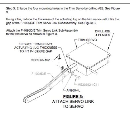

Hey All -
I'm trying to get my elevator trim servo mounted this morning. On page 11-9, Step 3, its calling for a clevis pin to attach the servo link to the servo. It also calls for two AN960-4L washers on either side of the pin. For the life of me, I cannot find these. I looked in the inventory list and don't see it on there either. Am I missing something - or do I need to go get a 3rd cup of coffee?
