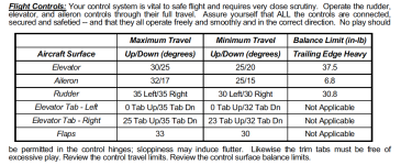

I have just done his. The required throws are 20-25 down and 25-30 up as specified in the "Flight Test" section of the manual. If you are concerned, you are permitted to file the stops to get the throws you require.

Does anyone happen to have a copy of the RV-10 Test Flight section from the manual that shows the acceptable elevator range of 20-25 down and 25-30 up? I searched the electronic and paper manual to no avail.
Here's a screen shot of that section. If I remember right, it was part of the finish kit instructions????
